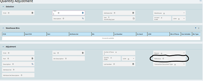

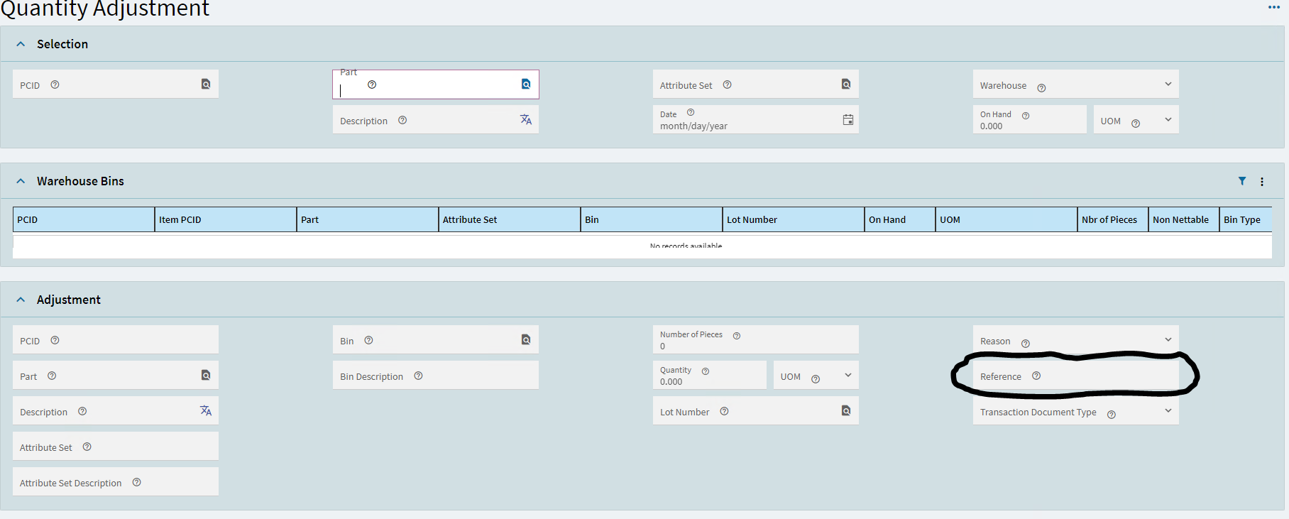

Out of all the reports I have written, I have not done one like this in the past 6 years. So…I’m needing to pull in data from a large amount of Qty adjustments that have a unique reference code. However, I am not sure which tables to use for this as parttran doesn’t hold the info. Any help is appreciated.

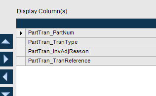

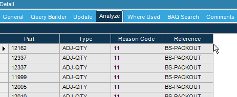

Part tran does indeed hold the data for quantity adjustments. What are you having issues with?
I need the reference and Reason Code that is used in Qty Adjust.

That’s all in part tran @Will79
Yeah, I completely missed those…
Thank you @Banderson
