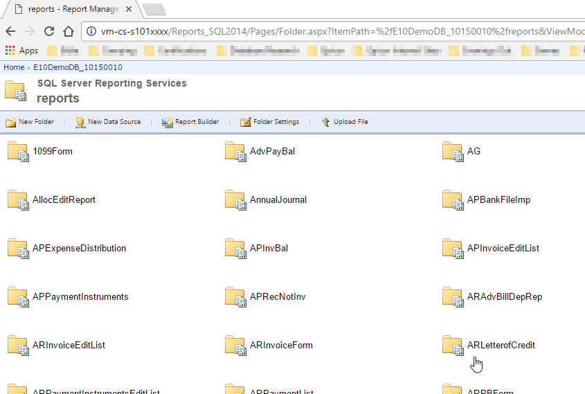

They are imported into the Reporting Services instance and at that point, they are more like _logical_ files that are actually records in the Reporting Services database; deployed SSRS reports aren't files on the file system like Crystal RPTs. They can be located in the root folder specified in your Reporting Service instance's Report Manager URL:

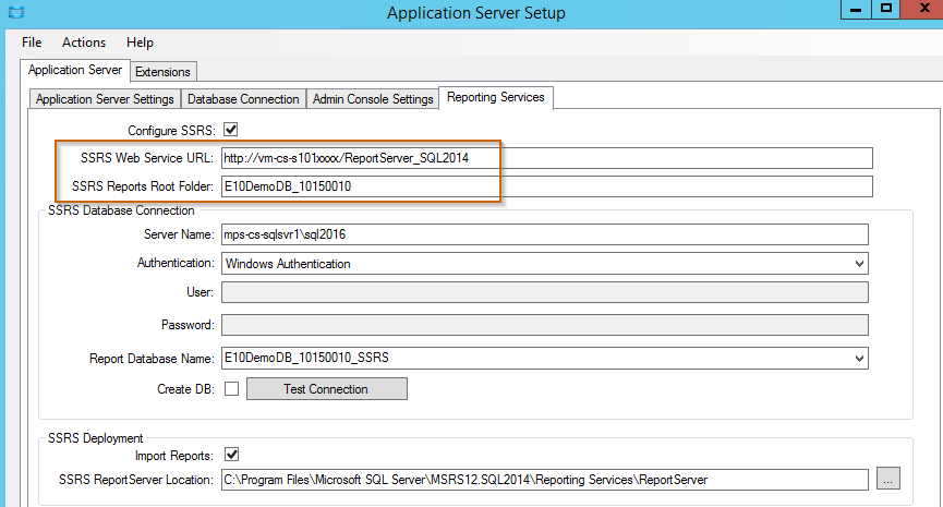

Based on the screenshot below of the Reporting Services tab of my application server's configuration, it would be http://vm-cs-s101xxxx/Reports_SQL2014/ and then open the _E10DemoDB_10150010_ root folder.

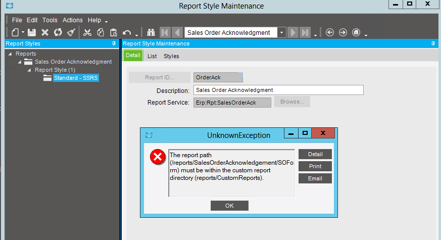

The **Download SSRS Report** in Report Styles is available for all SSRS reports, the **Upload SSRS Report** is only possible for non-system SSRS report styles.
My screenshots below are from an E10.1.500.10 install.
When I try to overwrite a base SSRS report:
