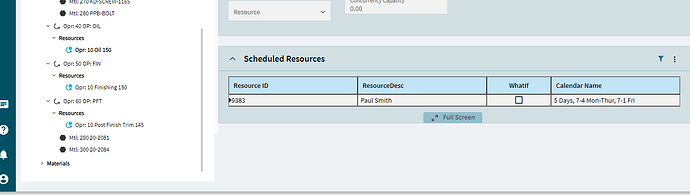

More than one scheduling resource (Op Dtl Seq)
There may be some other settings at play too, but this was from E9 days.
Oh, are you thinking that two scheduling resources that are both marked as Location might cause this?
I don’t recall the details but removing one of the resources also removed the double entry. Split Labor = Burden might have had a hand in it too, but it’s been a long time ago.
We have 6 resource groups all scheduled the same and have 1 assigned scheduled resource per and only have two resource groups where qty is doubling.
This only started happening in April.
Does that mean you mark employee resources as being a location? Employees should generally not be a Location, the machine/bench where they work should be the location.
