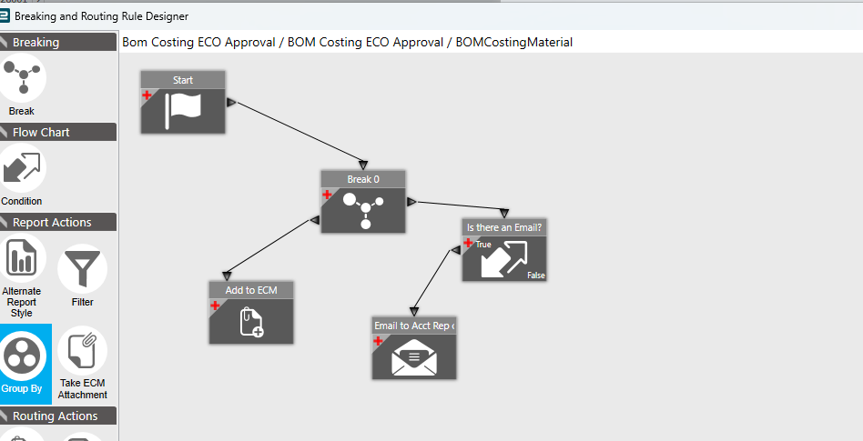

Report Style Multiple Break Endpoints
Trying to create a break rounting to add a file to ECM and then if there is an email, email the item with attachement to said email address.
Right now only able to get one or the other to work (last attached) what gives. Do I just have to create another report style, one to add to ecm and one for emailng users?
Help…

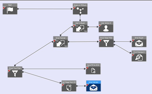

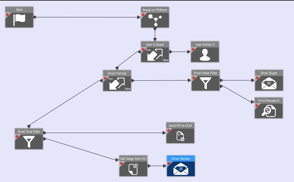

I don’t know if this is helpful or not… we actually haven’t used this routing since implementation.
The below was for PO’s… and we had set it up to email attachments to the Vendor.
… and I don’t have Power Tools set up right now to dig into the particulars of the set up… but that last “Filter” allows multiple branches off of it where we would Add the PO into ECM… and then pull part Drawings OUT of ECM to attach to the email.
You’ll have to test if timing allows in your case. But the Filter may allow you to do multiple end steps.
That appeared to work thanks.
