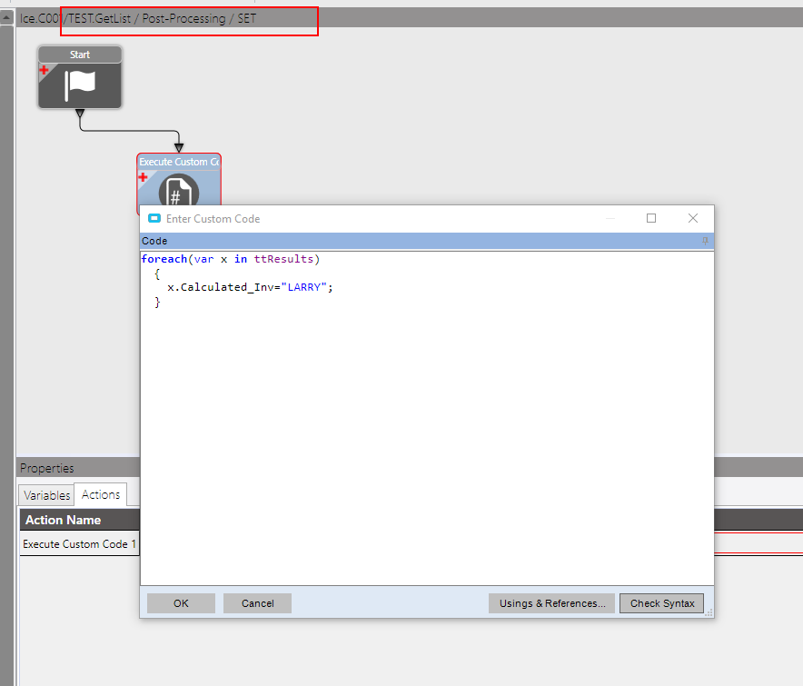

In 10.2.200.10, I created a new Report Style with a BAQ RDD for a BAQ that had parameters (because the BAQ Report Designer doesn’t support setting BAQ parameters, at least it’s not obvious if does). This particular BAQ has a custom GetList post directive to do some additional processing.
When the report is run, it doesn’t fire any of the directives, whether it be pre, base, or post. I even put a exception message in each one and it doesn’t care. Now, if I run the same report without setting the BAQ paramaters using the BAQ Report Designer, it will throw an error in the task that can be seen in the system monitor.

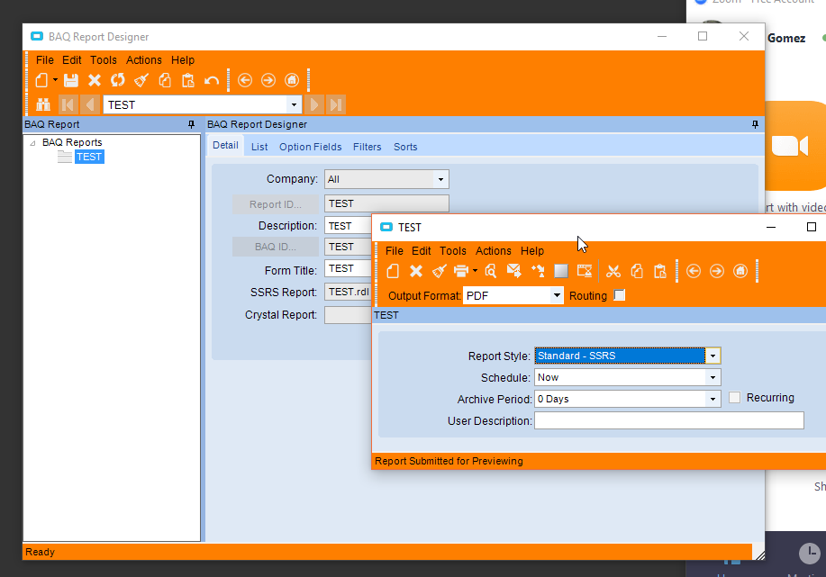

I verified in 10.2.300.X It works

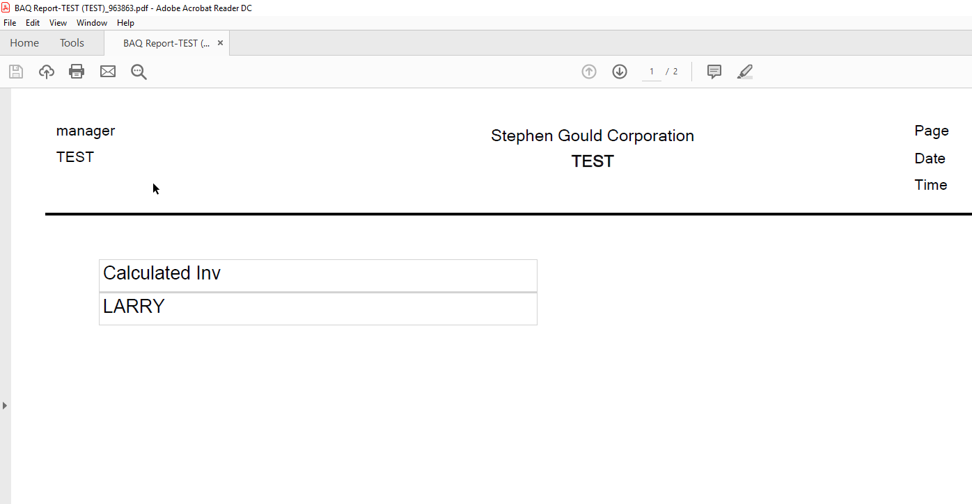

Thanks for looking into it. The BAQ Report Designer does fire the directives as you mentioned but if you manually create a RDD with BAQ as it’s data source and manually create a new Report/Report Style that uses that RDD, it does not. At least for me it didn’t. I tried this on our 10.2.400 Test Environment too.
So:
BAQ Report Designer(Submitted through Ice.Proxy.Rpt.BAQReportImpl): Supports directives but not BAQ parameters.
Hierarchical Report Style with RDD w/BAQ(Submitted through Ice.Proxy.Rpt.DynamicCriteriaImpl): Supports BAQ parameters but not directives.
