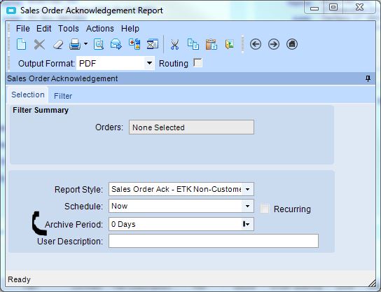

When you print an item select how long you want to archive from the drop down.
Capture3
When you submit a report in the “Print Form” select the Archive Period from the drop down list. Day, Week, Month…
Thank you very much, Ken and Mazin. I got it. For a report, we get different TableGuids for each time we run the report. Is it right?
