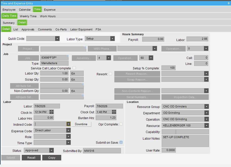

We are having an issue in MES where labor hours are not being captured after ending a Setup activity.

After ending the setup activity, the labor hours do not populate / are not captured on the operation. We have checked the production standards, setup hours on the operation, and resource configuration, but have not been able to resolve it.
We are also entering production completed quantities (on MRP-planned jobs). The issue appears specific to setup activities — production run labor seems to work normally in most cases.

  • Labor appears to start (activity shows in Started Activities), but after End Activity the hours field stays at zero

We are on Epicor ERP 10.2.
Any ideas or things we should check would be greatly appreciated. Happy to provide screenshots of the operation configuration, Job Tracker, or BAQ results if needed.
Thanks in advance!
Could it possibly have to do with the Expense code being Direct Labor? At our company, Direct Labor produces something to stock/job/order, Indirect is for everything else. We have our Setup as Indirect, and Production as Direct.
