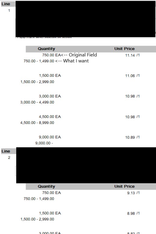

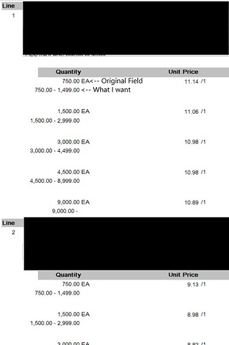

The screen shot below is what it looks like in Report Builder without Print Layout selected. You can see it’s working correctly for Line 1 and Line 2 of the Quote.
This isn’t the final version of the code I want, but this is the expression I used in the textbox.
=FormatNumber(Fields!SellingQuantity.Value, First(Fields!DecimalsQuantity.Value, "RptParameter")) & " - " & FormatNumber(Lookup(Fields!QtyNum.Value +1,Fields!QtyNum.Value, Fields!SellingQuantity.Value -1, "Quote"),First(Fields!DecimalsQuantity.Value, "RptParameter"))

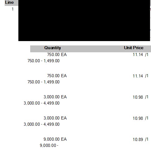

Once I click Print Layout, or just print to pdf, the data changes, duplicating info, as shown in the screen shot below for Line 1 only.
QtyBreak_PrintLayout_Line1

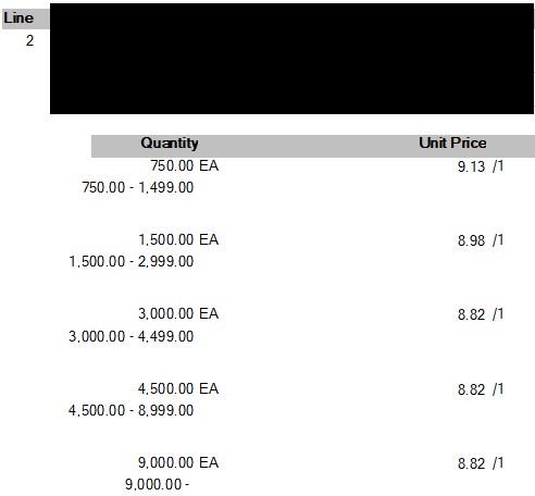

Here is Line 2 in Print Layout working as it should (ignore the matching Unit Prices, the Quote isn’t finished).
QtyBreak_PrintLayout_Line2
