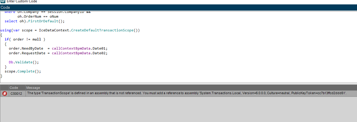

It seems im getting an error because TransationScope is defined in an assembly that I am not referencing in my BPM, but it does not state which assembly it is I am missing. We are running epicor in the cloud, not on prem, so how which assembly would I need to run in order for my code to validate ?

Sorry, it does say which assembly, but System.Transactions.Local is not present in my standard references which I assume is because we are not on-prem.
This may be helpful: Kinetic 2022.1.1 Transaction Scope - Kinetic 202X - Epicor User Help Forum (epiusers.help)
I saw that post at one point when I was doing research before resulting to responding to your post and that is the same situation I am having
The problem for me though is unfortunately the solution posted there is to download and install NET 6 SDK on the client and I do not have access to that because we are running Epicor through the cloud not on Prem.
Iv’e been trying to figure out a work around and I was hoping maybe you had a solution that avoided that.
Seems as though all of my issues I am running into with this BPM are related to being on the cloud :frowning:
You download it to your client, AKA your own computer, not the server.
Oh my goodness lol, thank you. I tried that and it got the code to validate! :smiley:
