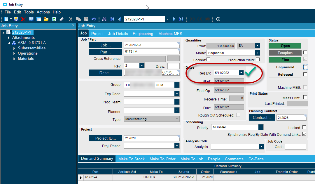

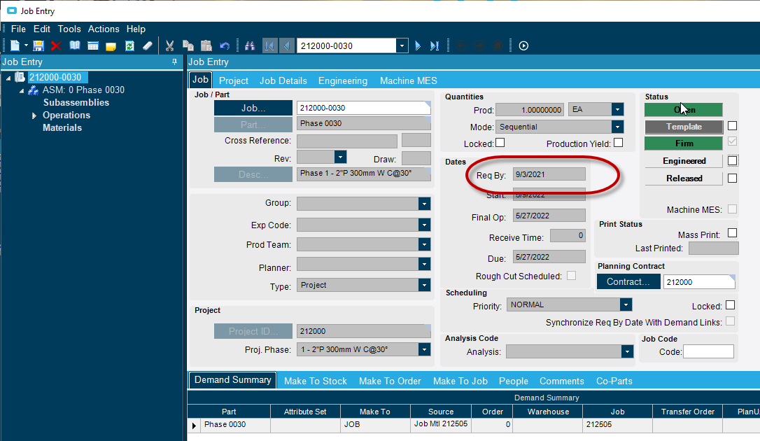

Here is something we can’t figure out. On a Project Job, you can’t change the Required By date. The field is disabled:

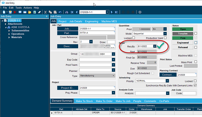

On a regular manufacturing job, you can:
We would like to be able to change this date on project jobs and it doesn’t seem like we are able to. And I don’t see any where on the Project where you can change it.
Any ideas?

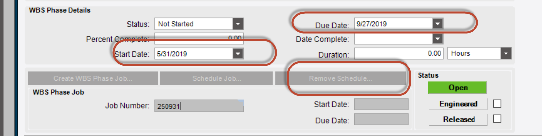

Remove it from the schedule on project entry then edit the dates here.
jimship
(Jim Shipley)
May 11, 2022, 12:48pm
3
That works. Thanks!
