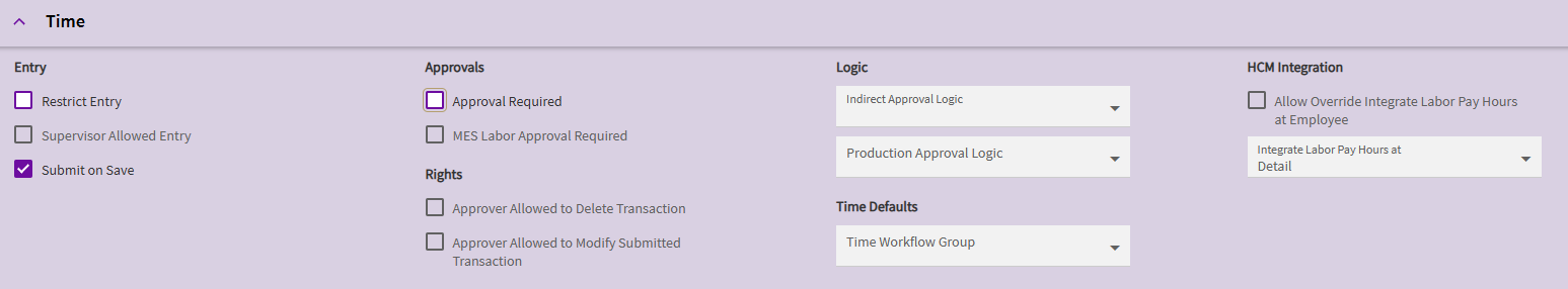

In the Site Configuration screen, there is an option to require all indirect codes to be approved.

I think the issue is that the approvals process happens outside the labor.update transaction and thus a method directive doesn’t work. For starters, I’d double check to see if the labor data set produced by time entry has a flag that determines Automatic or Employee approval (the setting from Site Config). If you can see that, then you can flip that based on the indirect code.
