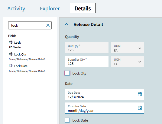

Have you played with the Lock Qty/Date fields on the PO Release?
These flags tell MRP, “I know what I’m doing. Don’t touch this.”
That works great! Thanks!
