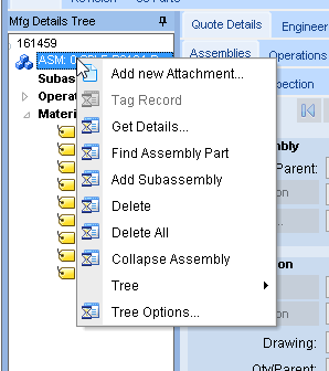

  7. Remove Details - using right-click context menu on the Quote Details tree/menu.
  8. Run GetDetails again - the painting operation is KEPT in the MOM.
You must do #7 in order to ā€˜reset’ the MOM and to re-apply all of the configurator rules properly in case there are related dependencies on the Paint operation or color choice.
:exploding_head:
And I’ve been manually selecting and deleting each operation and materials, row-by-row, all theses years …
@MikeGross - Where exactly to right click? The only thing that looks close to a ā€œRemove Detailsā€ is ā€œDeleteā€ or ā€œDelete Allā€ which only show when right clicking the ASM level of the tree.
In our case we are a single assembly, so Delete All is what we choose. I’m not sure how that would work on a multi-assembly MOM.

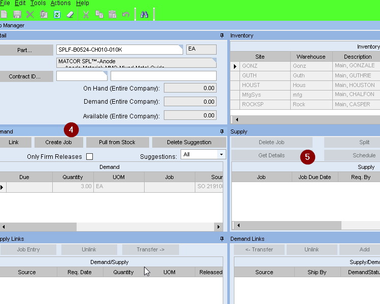

If you use the Job Manager to create the Job, it links the Job to the order (and line). The using Get Details in Job Manger, it uses the configuration from the sales order. Here the steps and what happens.
  1. In order entry, Part SPL-FGR-CFG (a configurator) is entered on a line.
  2. That part is then configured. Our Cfgrtr creates a Part entry but no method. After configurator closes the Orde Line now shows the configured P/N (Ex: SPLF-B0524-CH010-010K)
  3. Job manager is launched (from within order Entry, Actions -> Order Line-> Job Manager).
  4. In Job Manager, the Create Job button in the Demand area is clicked and a job is created (we use the Order-Line-Rel format). The job will automatically have the demand links for Make to Order qty. The job will NOT be marked Engineered.
  5. Still in Job Manager, you can select Get Details for the job, (the job will appear in the Supply area list) and the jobs method is populated. Job is still not engineered.
At this point your review process could be done on that un-engineered job.
