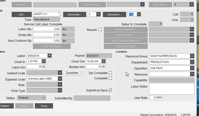

We just noticed that for some reason with one operation (paint) we have people that are clocking in and it will set the resource group as Shop supervisor. I can’t figure out why. I can use my own employee number, and start clocking into various jobs and notice that sometimes it’s paint like it should be, and other times is shop supervisor.
Has anyone seen this behavior before?

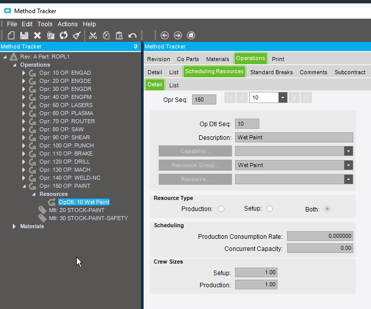

also check the method for the part you are making with the job. there are areas that can be assign as resource to the labor reporting resource.
So the same method is used on all of the whole goods jobs to set up operations for employees to clock time against. (I don’t want to get into why we set it up this way, just understand it’s how it’s done.) So every top level has this operation, with the resource group set as shown.
Here is it on a job
Somehow, this got set. But it’s not on all jobs. I Still don’t know how that got set, or what effect it has. I’m still trying to peg down a pattern on this.

So I have one example job, where the supervisor added the time in for an employee in T&E. Would the resource group default to his resource group and link that in the job? Thereby messing up anyone clocking in to the same operation after that one?
As long as they are putting the Emp ID of the one doing the work it shouldnt matter who does the T&E Entry.

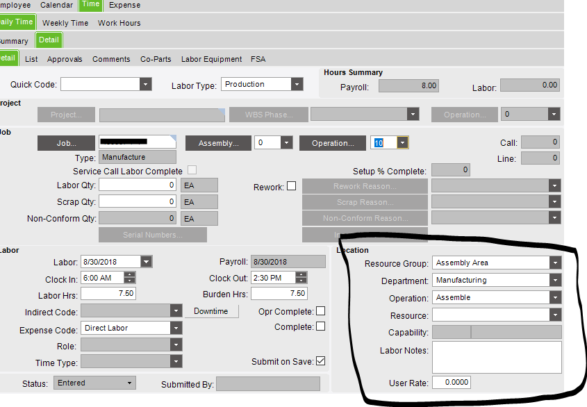

when the Op is picked it will default a resource on the right. is this coming over correct?
Looks like T&E is doing the same thing as MES.
