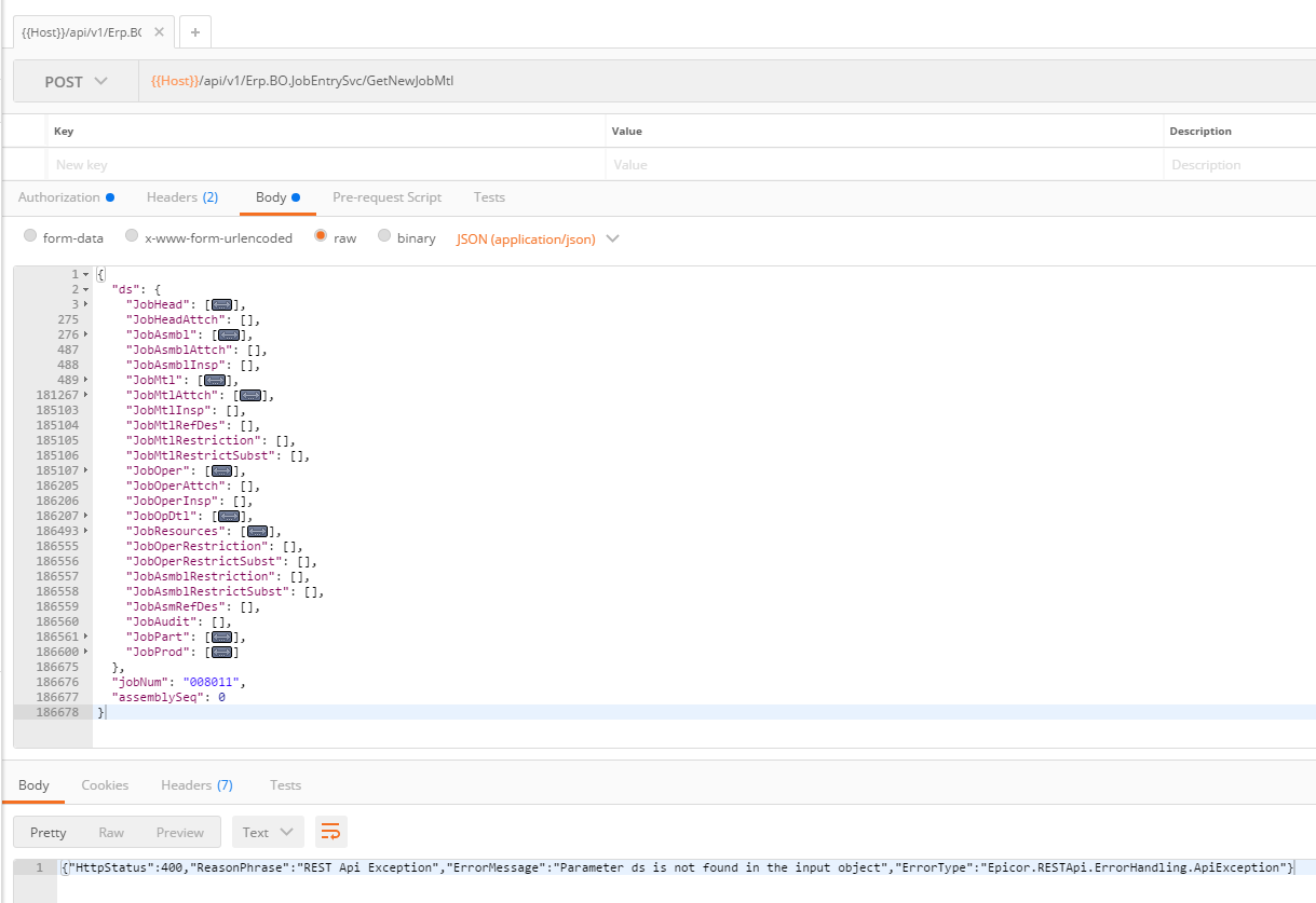

I am getting a strange error when calling GetNewJobMtl and not sure why, it only seems to be happening for this particular job as well. The json has been run through a validator and no errors are returned. The ds parameter is clearly there and correct.

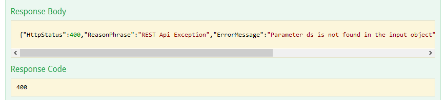

What about in SWAGGER can you make the call in SWAGGER with the results of a GetByID?
I tried using swagger too, same result.
Are you passing swagger the results of a GetByID?
Looking at the line number in your POSTMAN that’s 180K… your JSON is HUGGEEEEEEEEE how big is this job? Not that it should matter but geez
Yea, the job has 750+ materials added to it.
Correct, passing it the same json that I was using with Postman.
