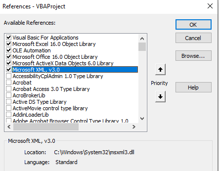

Adam: does MSXML2.XMLHTTP still require a reference to Microsoft WinHTTP Services, version 5.1?
I think it’s in Microsoft XML v3.0. Not sure about the WinHTTP, could be there too. Here’s a snip of my references:
