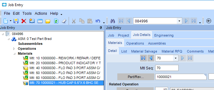

Generating a Get request to the API at: /JobMtls({Company},{JobNum},{AssemblySeq},{MtlSeq}) always returns the last material added to the job. Not the material requested.
I’m new to the Epicor bug fixing process so please bear with me.

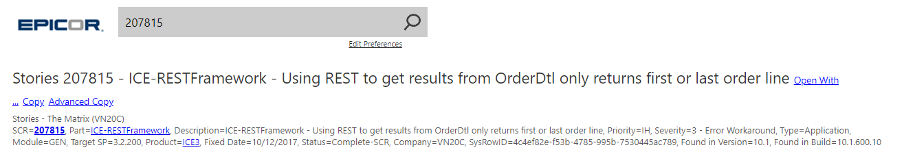

How can I look up the 207815 bug details?

Q2: How can I look up the 207815 bug details?
A2: https://scrs.epicor.com/ (and log in with your epicweb credentials). Information from the scrs.epicor.com site is the same information that gets included in our formal release notes when we publish updates/releases.

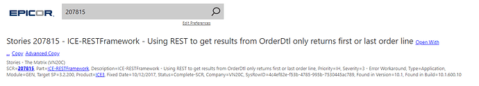

Awesome. The scr details includes the following: “Severity=3 - Error Workaround”. Does this mean a workaround exists? If so, is there a way to look this up?
