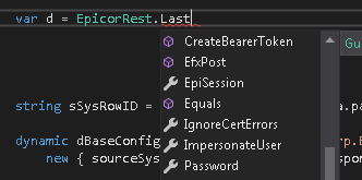

@josecgomez , just updated to EpicorRestAPI 2.0.3
Has something happened to EpicorRest.LastCallHeaders? I don’t seem to be able to access it.
Am I missing something?
Thanks in advance!
Thanks in advance!
Thank headers of the last call are going to be in the last response object
Thanks Jose. The following worked:
dynamic dContext = ((IEnumerable<dynamic>)dBlankConfig.Response.Headers).Where(header => header.Name == "ContextHeader").FirstOrDefault();
