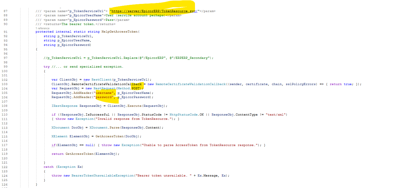

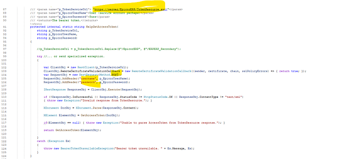

However when I try to interact with the rest API I’m getting 401 errors. I’m starting with the “TokenResource.svc” like so:
https://server/EpicorERP/TokenResource.svc
It is used to get a bearer token. But it always returns a 401 error. Here is the code

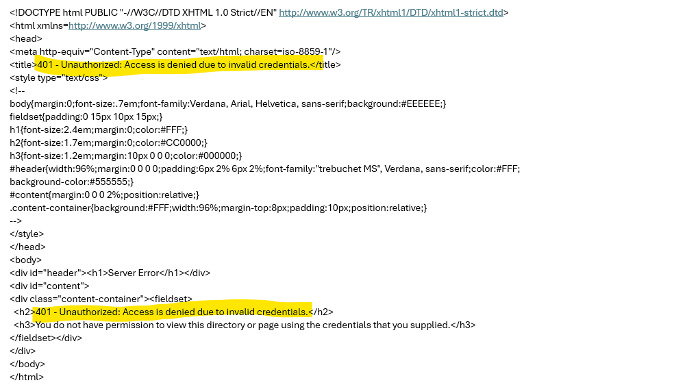

The error is like so:

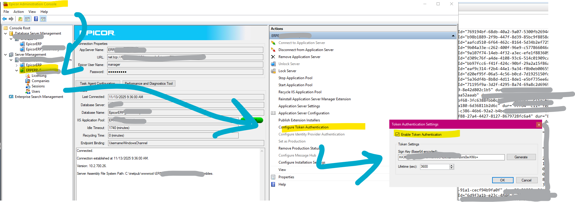

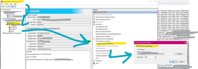

I’m not sure what token auth is for. Will this interfere with the REST API?
I’m going to close this. I am almost 100% certain that the requests that are failing (401) are related to IIS misconfiguration. These requests are probably not even reaching any Epicor software in the first place. The content bodies of the 401 errors look very generic, and I am pretty confident that I can’t generate a token, since the initial tokenservice is not reachable with anonymous access. (or something along those lines).

And yes, token settings in the Epicor Admin Console are used for the method you are trying to execute
