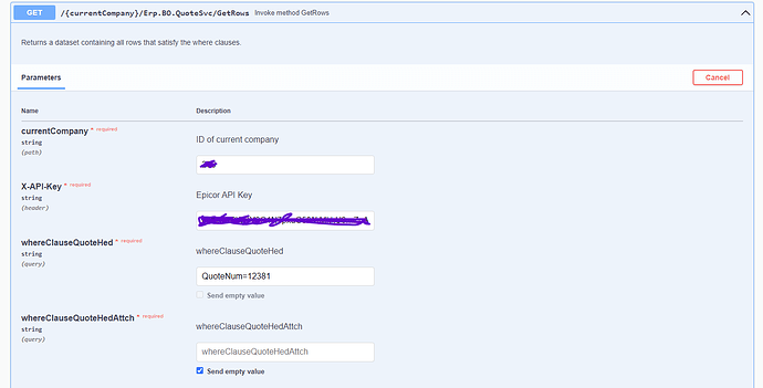

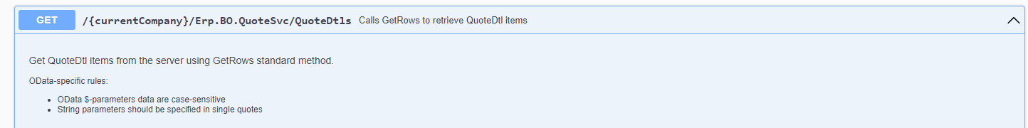

Thanks this definitely gives me something to think about, as far as I understood this was the way to call the actual methods just from reading the docs on the API help website:
I feel like I’m missing something, what is it?
Yeah about the BAQ, I can also use that if needed, but I would think that for something simple like this a “standard” service was the best option.
But now you’ve made me think this is not the “standard” service haha.

Now I’m looking at those Custom methods @klincecum suggested, the GetRows seems like a pain in the sense that it needs all those whereClauses to filled in or empty, also no filters, sorting, selecting that I can see
But it does seem to return the full quote as a nested json object, not ideal but I can live with it.
