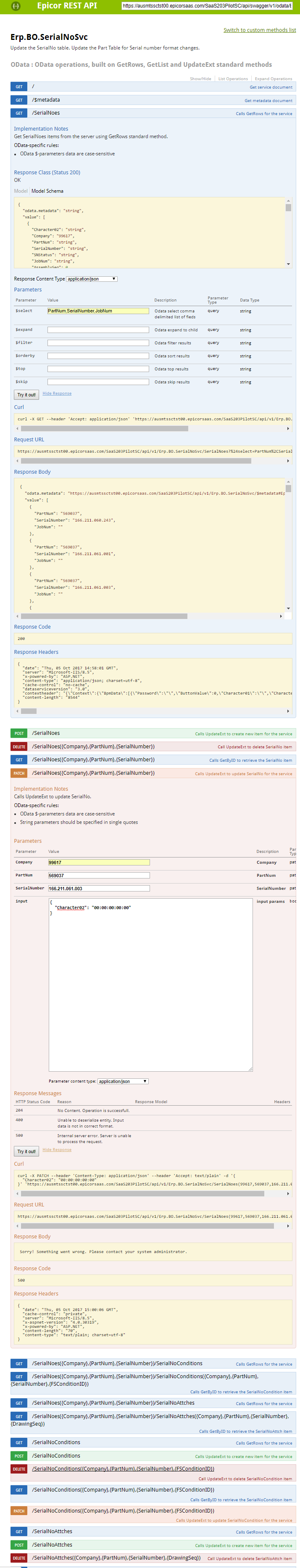

Love the REST API functionality, so far just used it to extract data. Currently working on an app to load data to the serial number table.
We are multi-tenant hosted.
I get the attached error when trying to Patch. Question: Because I’m MT Hosted are we unable to write? Do I have to have permissions to do updateable BAQ’s?
The error response is the general bucket error ‘Something went wrong’?

I think you need to pass more fields. As hosted you don’t have access to event viewer. I would ask support to turn off custom errors so you can see the actual error in the response
Try passing the entire model from above back in the below. At a minimum to make life easier in troubleshooting, do make sure to as Jose said “ask support to turn off custom errors so you can see the actual error in the response”
We will need to test the underlying service. You don’t have BLTester so we will need to annoy the support folks.(Hmmm… conversation time with the Product Manager of SaaS)…

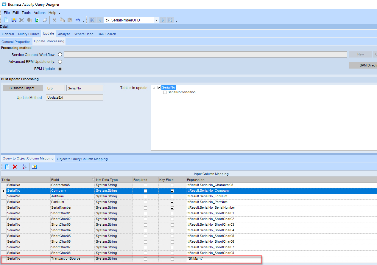

I tried to create an updateable BAQ to do the same thing and was getting an error. Called TS and the Rep had me add “SNMaint” --> TransactionSource and it worked on the BAQ. Thought maybe it was related and tried it on the REST Patch and it worked. Seems like TransactionSource should be a Rq’d field.
Both UBAQ and PATCH in REST are working with UpdateExt functionality of the business object. So yes, they both will require similar field, like TransactionSource here.
