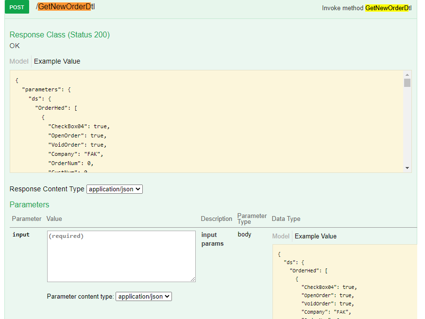

In the REST API when you call the GetNewOrderDtl it should come in with the next available LineNum pre-assigned and then you make changes to everything besides the defaults and Update, no?
For SalesKit I think you need to use GetNewSalesKit
I’m posting this off
Erp.Bo.SalesOrderSvc/OrderDtls

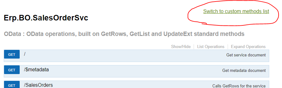

You can access the Custom Methods in swagger
https://YOURSERVER/Epicor10Prod/api/help/v1/methods/Erp.BO.SalesOrderSvc/index#!/Custom_methods/GetNewSalesKit

  • GetByID(orderNum)
  • GetNewOrderDtl
  • Update
In your php code basically each call should return the dataset you will keep passing like a ball to the next API Call
  1. GetByID(orderNum) : returns All Tables for that Order (OrderHed, OrderDtl, OrderRel…)
  2. GetNewOrderDtl : creates a new OrderDtl with defaults figured out and RowMod = “A”, you make changes
  3. Update
