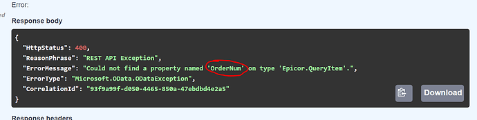

I am working with v2 and trying to retrieve data from a BAQ that has built in parameters: @BeginDate, @EndDate, @OrderNum, however, I can’t figure out / find the syntax needed to set this data in the filter.

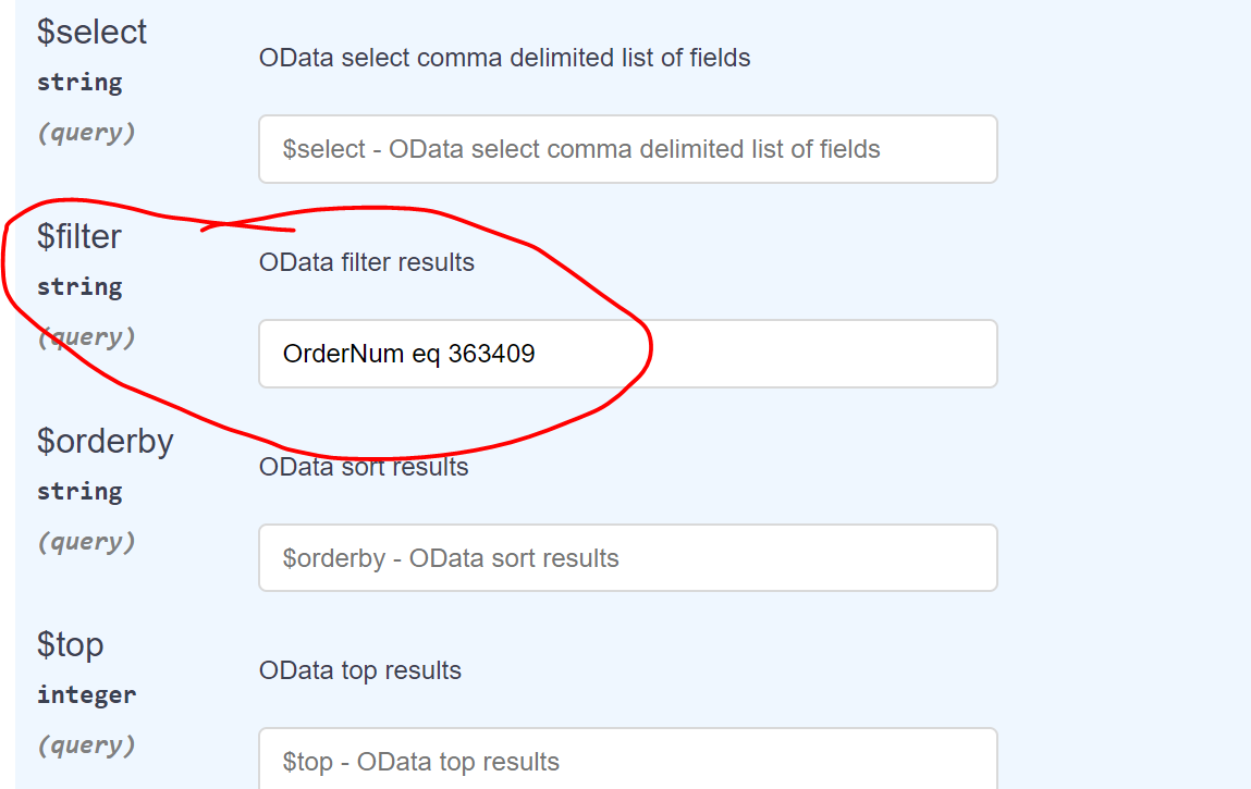

I’ve tried:
@OrderNum eq 363409
OrderNum eq 363409
$OrderNum eq 363409
What is the syntax to pass along a parameter in the filter?
Thank you.

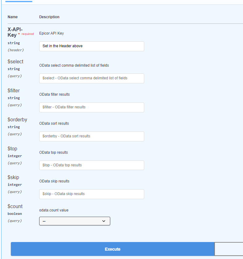

No, I’m trying to pass a parameter value to the BAQ and there doesn’t appear to be the ability to to do this through the API GUI in my screenshot.

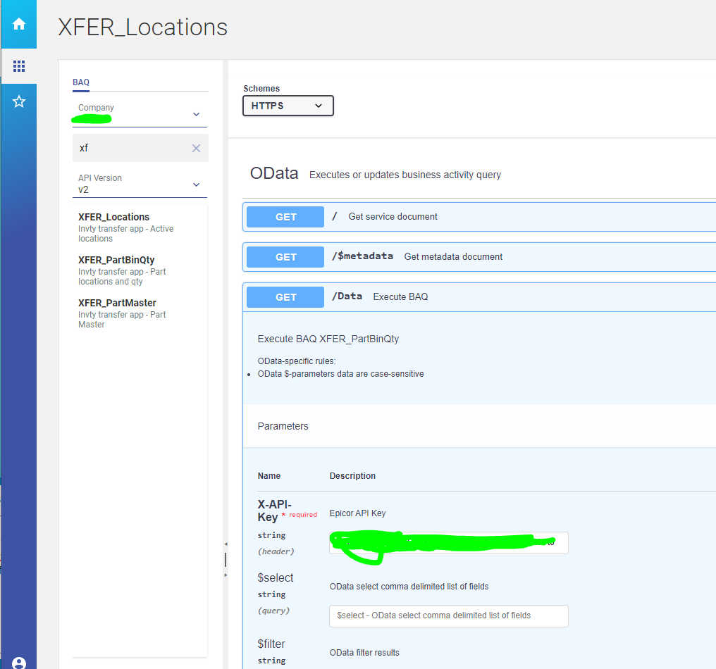

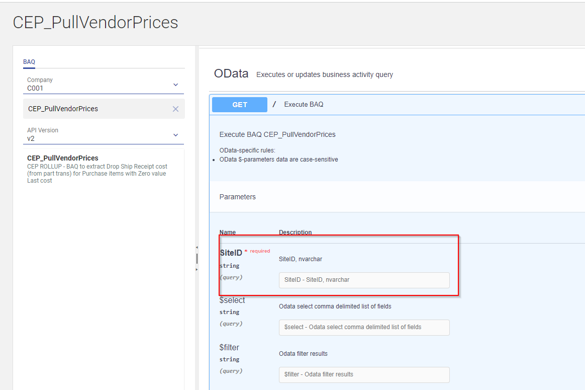

What do you mean the Parameter shows up right here
It doesn’t for you? Mind you i’m in 2021.X
Hooray! They fixed it!

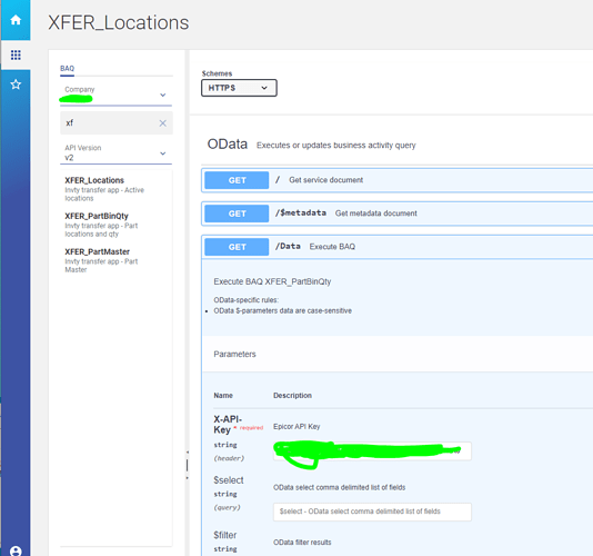

No, through 700 it’s not there:

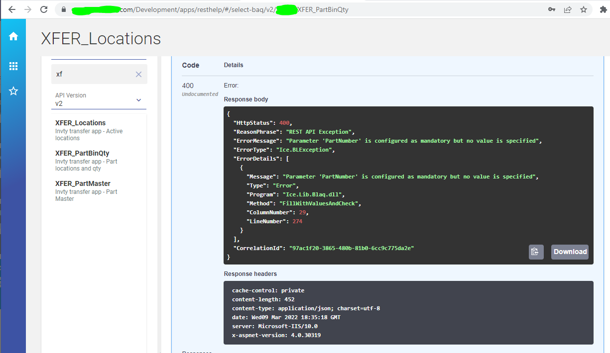

Looks like this is broke again in 2022.1.11 :frowning:
This BAQ has two parameters defined and none show up
Interestingly if you select v1 on the dropdown the Params show… weird…

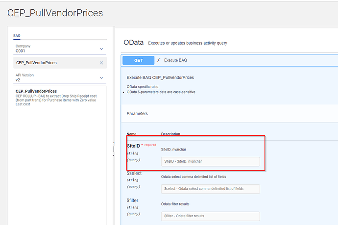

That is interesting, I refactored to use the v2 api and is working good again
