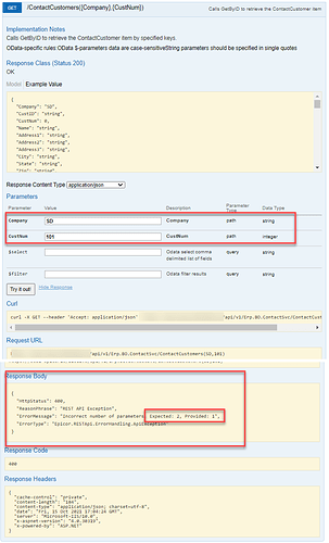

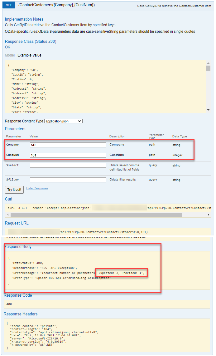

Just testing a REST call and getting an error. Says I don’t have enough parameters, but it looks like I’m sending the correct amount.
Seems like this is a bug because GetByID is overriden in this particular BO.
Try using the custom method GetByID instead of the OData version.
