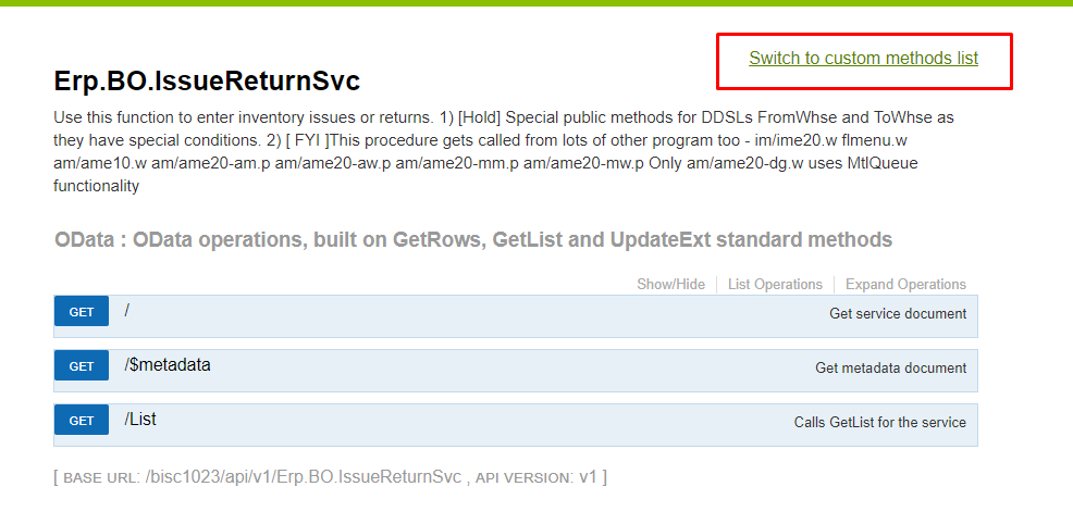

We are on 10.2.400.10 and are also looking to issue material to job via rest. We have SMT placement equipment that drop/reject parts (normal process) and we can extract that part/quantity information through a summary text file. Currently, I am just trying to test the Material Issue through Swagger to prove it out but have not been successful so far. I can make it work as a Quantity Adjustment but not as Issue Material as it fails during the PerformMaterialMovement (Parameter plNegQtyAction is not found in the input object).
I’ve read the Rest documentation in Epicor help, the REST Overview Novel, taken an extended education Rest class a couple of years ago and read many, many postings and this posting is exactly what I am looking to do, but I’m sure I’m missing something.
