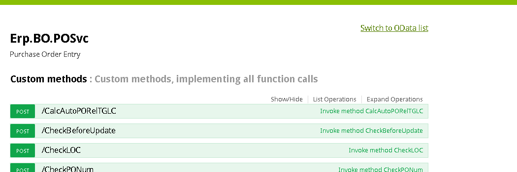

I believe he is referring to the custom methods in REST. There is a link in the top right of the REST help page to switch between standard calls and custom methods (BO methods).
These methods are mapped to the BO methods that you would call from inside the client.

Now you have a decision point. Do you want to use the same exact APIs as the client does today (the Custom Methods Chris mentioned above) or do you want to use the OData Methods?
Pro - They give you more granular control and are a bit more stable to use from version to version.
Con - Since they are not what the win forms client uses, the functionality is not 100% the same
Another alternative is to use a combination of BAQs for data querying and the OData update approach’s - Post, Patch
