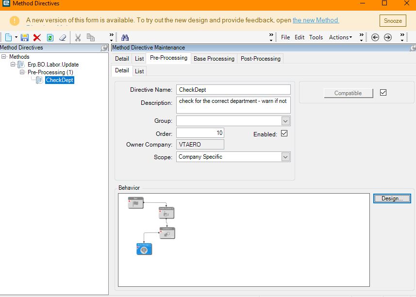

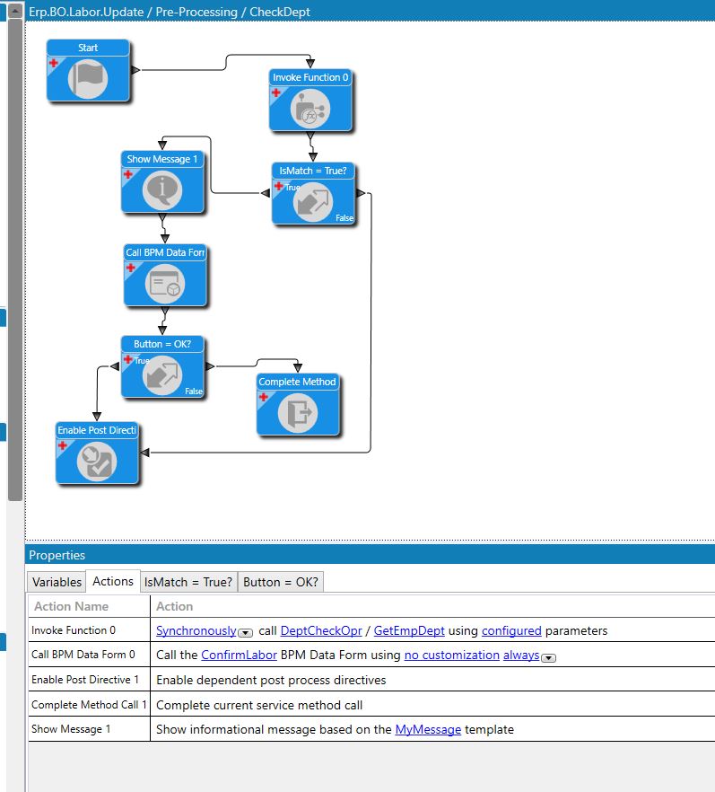

Will your users correct it if you just throw them a warning? In a pre-processing Labor.Update BPM, you could pop up a dataform for ttLaborDtl added rows / RowMod == "A" if the operation resource group doesn’t match the employee resource group. Then give them the option to continue (if they’re doing work outside their primary group), or cancel and select a different operation (if they’ve just selected the wrong op).
These are all good ideas. I think I want to make it a bit more flexible and allow the operator to log time against any operation where they are in the same department as the operator. If they are not in the same department then I want to just pop a warning to the user, but still allow them to continue. I think this would catch the times where they pick the wrong op.

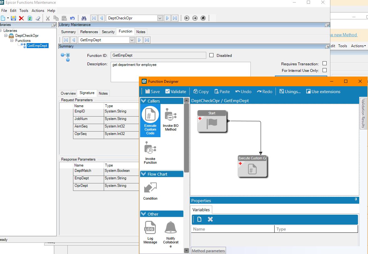

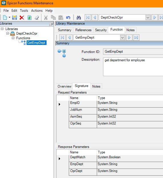

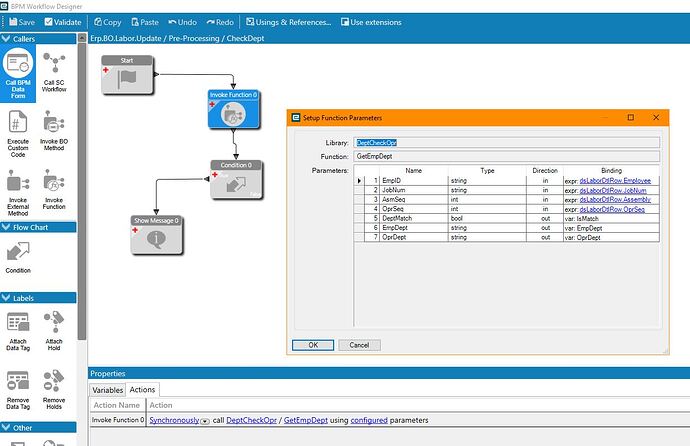

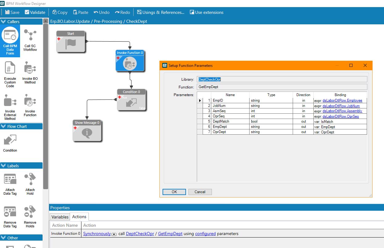

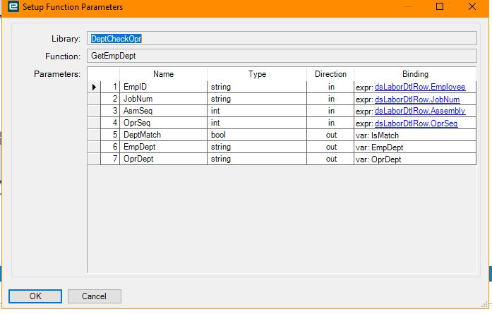

I am starting with a function. I think that would be the easiest way to compare the departments for the operation and the employee. If I setup the function to take in the Employee ID, how can I quickly return the department ID? I think I would also need another function to return the department ID for the specific operation. I think this is based on the operation’s resource group. So I would have to pass in the job, assembly seq, and operation seq to return the department.
Does this seem like a good approach? Is there an easier way I can just make one function to compare the two departments? It always seems easier to me to do it in small steps.
I used this code in my function:

This function seems to work well enough. The only problem is that when the departments do not match, the labor entry still proceeds. I think I am missing something in the method directive:
That looks good to me. I like that you’re doing all the checking work in the function. The only thing I’m concerned about is that there’s no “Cancel” option. Your BPM is on the Update method, so if you show the message that it isn’t a match, they can’t go back and correct it, it’s already updating.
I agree! That is what I am trying to figure out now.

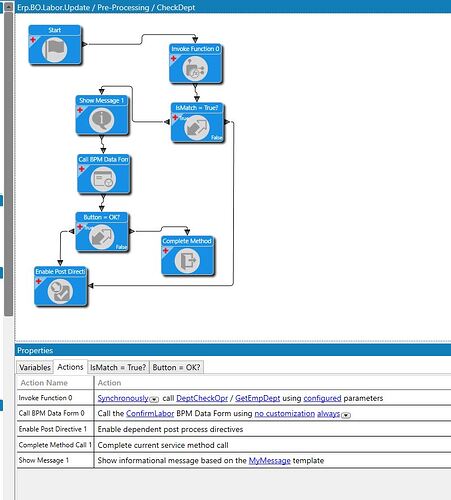

I would just replace the “Show Message” with a BPM Data Form. Use the same text from the message and add “Continue anyway?” If they select no, throw an error that just says “Labor Transaction Cancelled” or something like that.

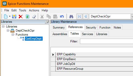

I added JCDept to the table list in the function. Why can’t it find JCDept.JCDept? Do I need to reference it in another way? I am using the following usings:
using System.Linq;
using Erp.Tables;
Thanks!
I see it is related to this post: Linq bpm get JCDept.JCDept Description - Epicor ERP 10 - Epicor User Help Forum
Changing to JCDept1 is all it took for a solution! Woo!!!

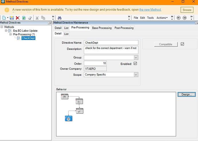

This is great! When user submits labor entry, if the departments match, then nothing happens, the labor entry goes in as expected. If the departments don’t match, then user gets a message showing the two departments, then gets a BPM form with OK/Cancel, I would like to find a way to have only one popup.
Can I get my department strings from my function to show inside my BMP data form? Then I could get rid of the extra message box showing the two departments, and just put it all in the BPM form.
