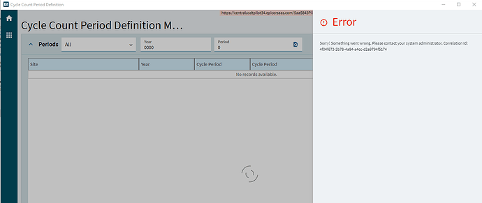

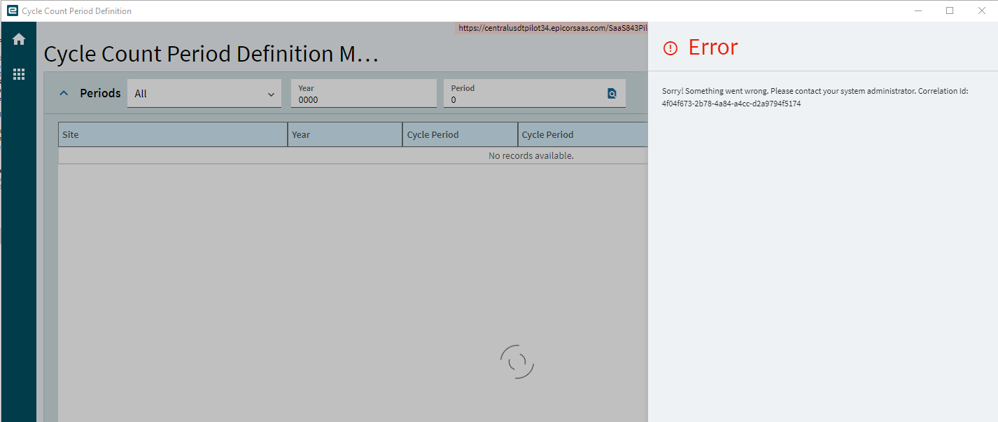

BPM validates fine, but when I open the CC Period Definition, I immediately get a “Sorry! Something went wrong.” error. When I close that, the grid loading circle turns forever and the grid is locked up with no results showing.
