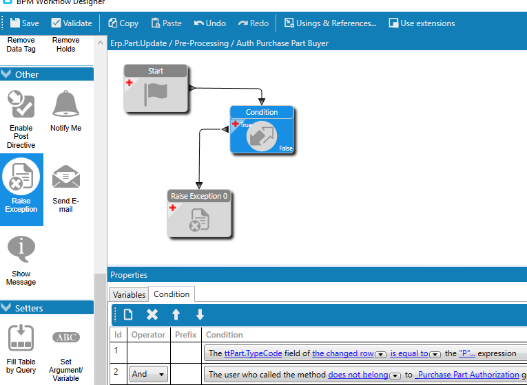

You could use Field Level Security on the OpenRMA field or create a BPM to restrict it to security group. This is a BPM that restricts Part update for purchase parts to a specific group only.
Thanks. I tried changing the OpenRMA field to Read Only, but it didn’t seem to work. I’ll try the BPM method and report back!
The BPM worked! Thank you! The illustration was helpful since I’ve only done one or two BPMs so far.
