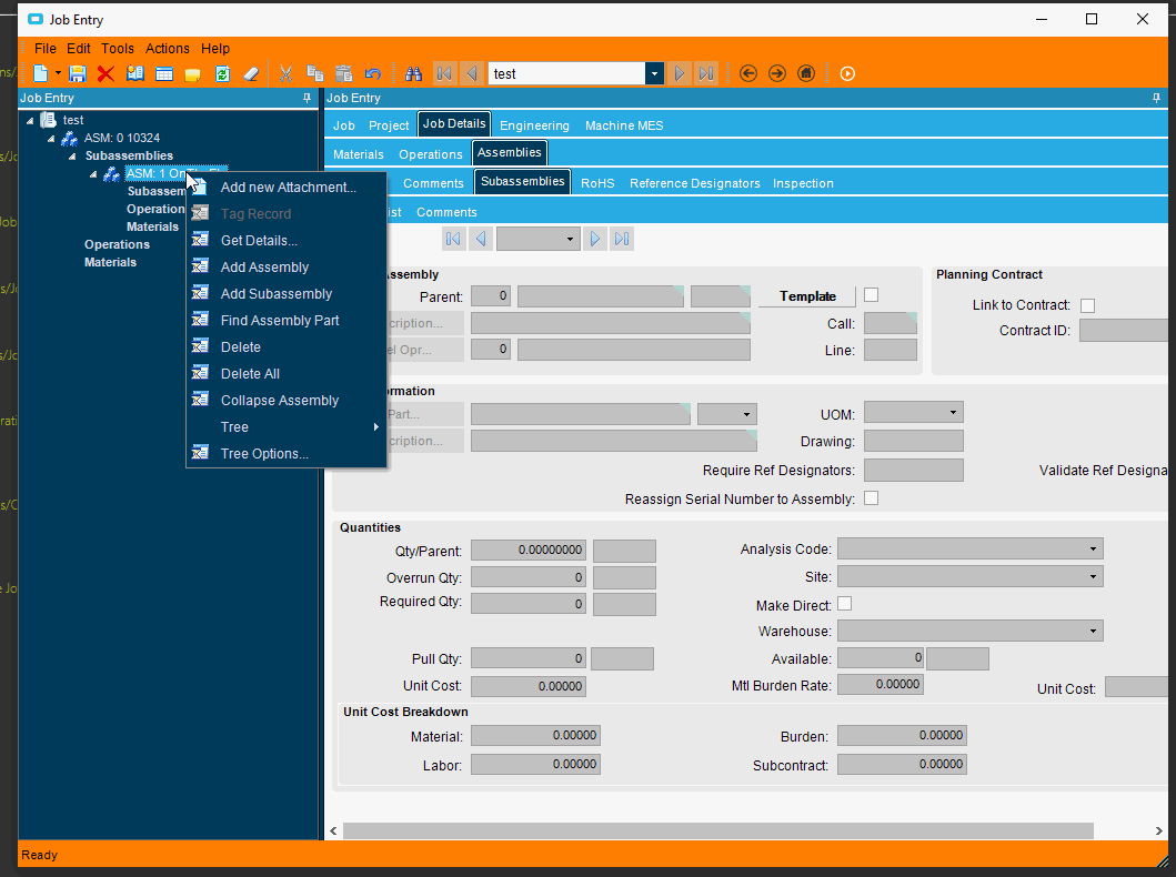

If it’s something that you do a lot of, you make make a part number that holds a template BOM. Then on the job, you can append details and find that template and it will add what’s in the template BOM. You can add that part wherever you want, and it will add what what’s already there.
Sorry to nercopost, but this is the most relevant post I’ve found for the issue I’m facing. Do you notice in your GIF there that, when appending details to a job that already has manufacturing details, the scheduling resources are not pulled in for any appended operations?
We’re running 10.2.700.8 and have been coming across this scenario more and more since we’ve been really leaning into Advanced Planning and Scheduling. Do you know if this is intended behavior and, if so, why?
