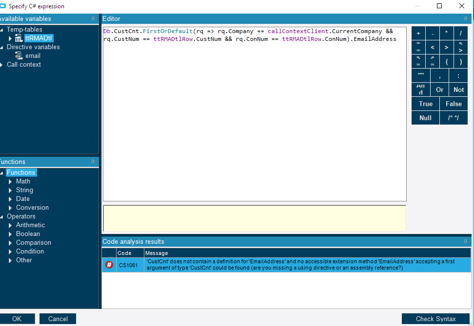

Did you get this working? I’m wondering how you connected the case owner email. I’ve got one using a variable but can’t figure out how to bring in the email.
I believe most email fields have a capital “M”.
If that fails, try this:

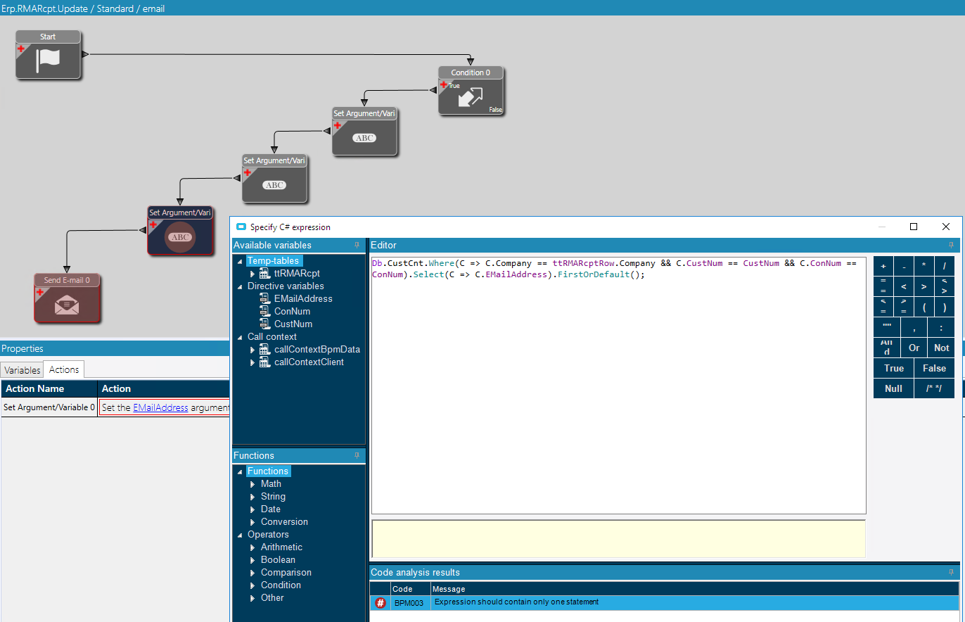

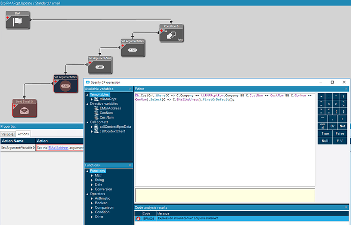

Db.CustCnt.Where(C => C.Company == ttRMADtlRow.Company && C.CustNum == ttRMADtlRow.CustNum && C.ConNum == ttRMADtlRow.ConNum).Select(C => C.EMailAddress).FirstOrDefault()
I moved it to the RMARcpt data directive feeding in the CustNum and ConNum from RMAHead. When iITry this code it gives an error
Ah. Remove the semicolon.
That was it, I also tried my original with the capital M and it worked as well! Man…the capital M :unamused:
