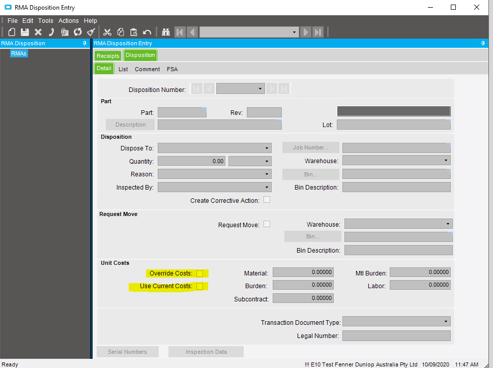

I just tested that with no invoice and the Material cost had a value, PartTransaction history did not add in the variance.
So what I ended up doing to replicate was:
Did a cost adjustment and set average cost to 0
Did a stock adjustment to put the inventory in negative
Did the RMA for a quanity that still kept inventory in negative, and I got the variance.
Interestingly during testing even though I had set the cost to 0 in Disposition entry the Material cost still showed a value. Digging into that a bit further the RMA receipt has cost fields that are updated, not 100% sure if they get populated from the Avg cost or the PartLot cost or the Last cost.
All I can conclude is it was a perfect storm, -ve quanity on hand and a part cost of 0 on the receipt, and the cost was not picked up on the Disposition.
