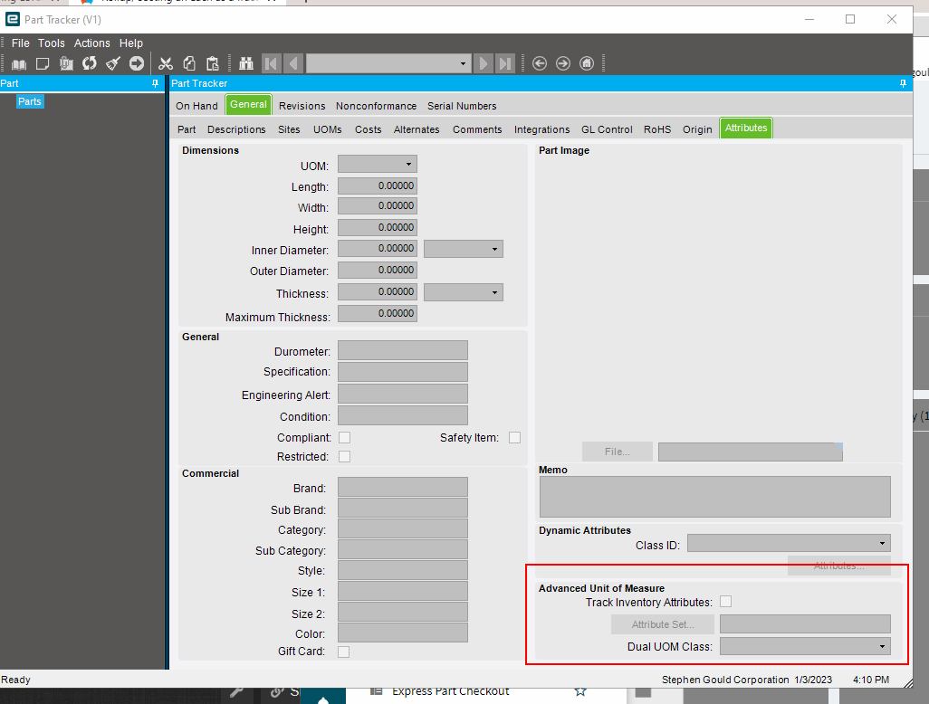

You could also take advantage of the Dual Class Inventory (Advanced Unit of Measure new feature) if you still want to track “eaches”
