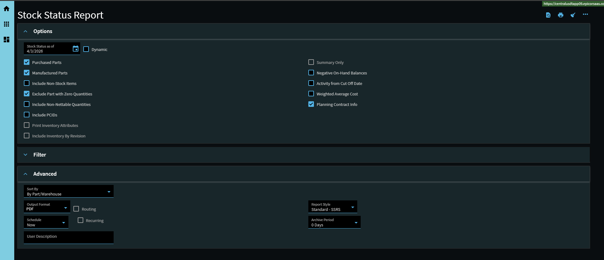

I am fairly new to Epipor, and am trying to setup routing for the built in Stock Status report. Is there a way to find the Report ID that drives this report?

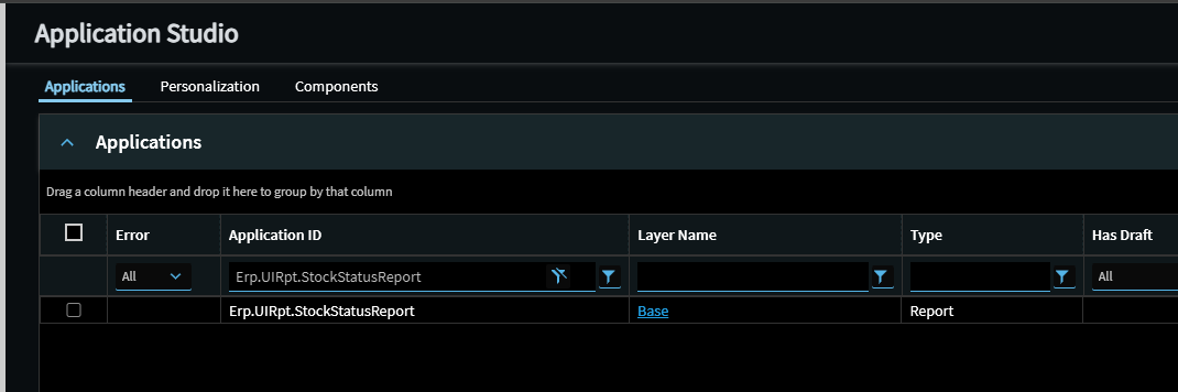

I was able to find the application in Application Studio, but have not found anything that points me towards how to access the report in report style to setup the routing.

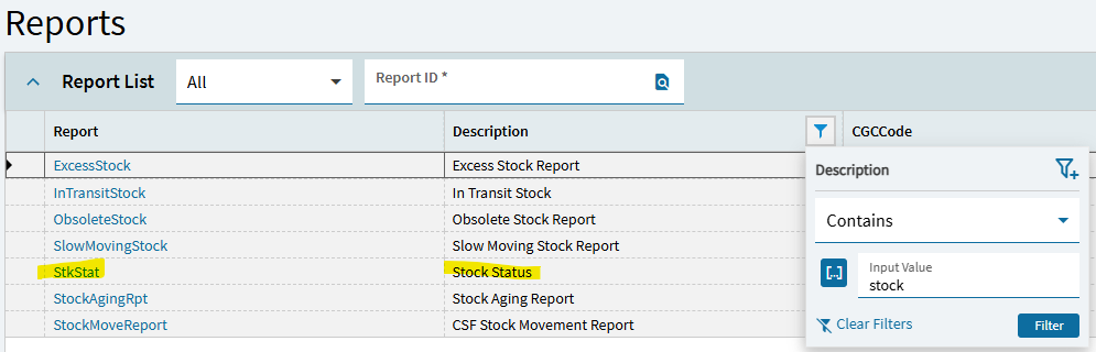

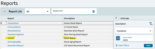

The easiest way is just to filter the landing page in Report Style Maint.
If I filter the description for “stock”… I get this subset:
Thank you - this helped!
