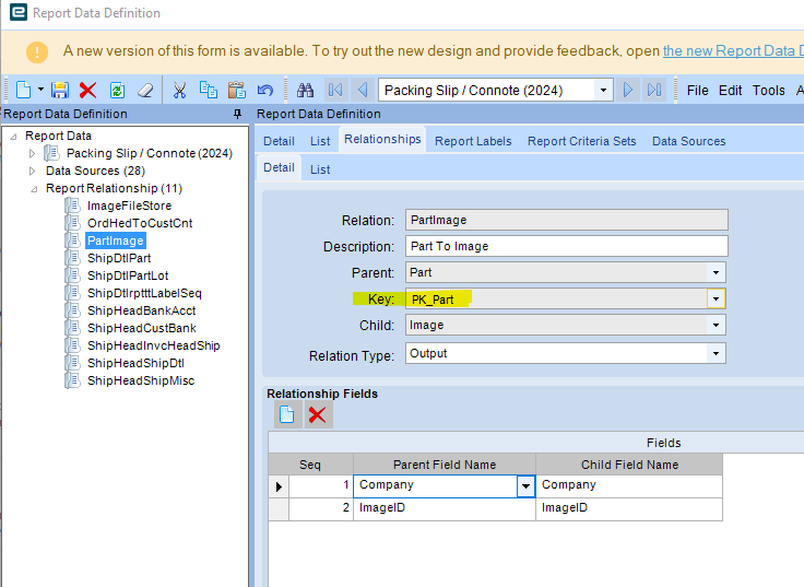

I did find that I could add a new relationship(clicking through the errors) and set the relationship fields by selecting one of the Keys defined for the table
That bought in the Relationship Fields I was looking for. That’s the only way I was able to set them
