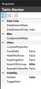

In the report, turn on Advanced Mode.
It is going to create a lot of (Static) lines in the groupings. Click on the line that correlates to the row. Looks like it would be the first one based on your screen shot. Go to the Properties and change the Repeat on new page property.
Okay I did that, went to save, and got this error:
The tablix 'Tablix1' has an invalid TablixMember. The TablixMember must have the same value set for the RepeatOnNewPage property as those following or preceding the dynamic TablixMember. (Expected Value: "True"; Actual Value: "False")
Sorry, I did not notice that it was included in a row group. Add a row above it OUTSIDE of the group. Add the field in the new row and delete the existing row. Then set the repeat on new page for the new line.
