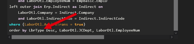

order by LbrType Desc, LaborDtl.JCDept, LaborDtl.EmployeeNum

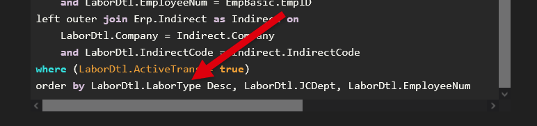

order by LaborDtl.LaborType Desc, LaborDtl.JCDept, LaborDtl.EmployeeNum
Yeah, your “order by” at the end is different. I believe it was because you were trying to order by a calculated field. Sometimes that can get wonky.

No, you literally picked a different thing to order by.
This is what you had, you chose the calculated field.
This is the new one, you chose the actual field.
Yes, I see it. I don’t believe that was intentional. I must have picked it because I didn’t have the calc field available then. Then I added the calculated fields.
So to be clear I don’t want to Order by a calc field, I should use an actual field.
Yup. I just didn’t want you thinking that it was just a random glitch that was solved by “Turning it off then on again”. lol
