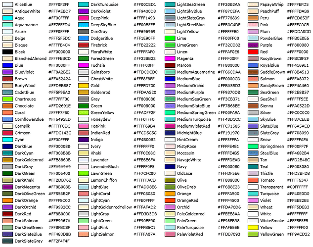

I can use any color name I find on this sheet.

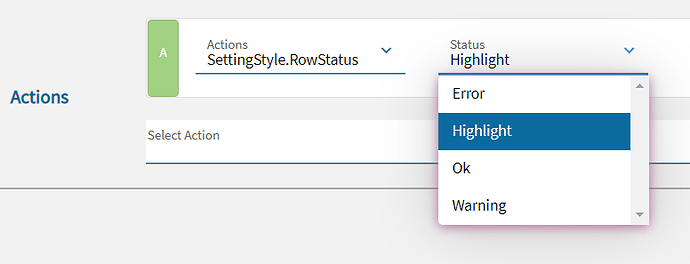

I am talking about the Kinetic Interface. I know there are data rules in the Application Studio, but I do not know how to use the highlight colors of my choosing (other than the 4 standard: Red, Yellow, Green, and Tan).
Yeah, I specifically asked about custom colors to use on row rules. They (Epicor) said that’s all we get right now.
Thank you for the reply Doug. Hopefully Epicor will add that feature soon because it is a quick way to identify when different actions are needed by the user.
