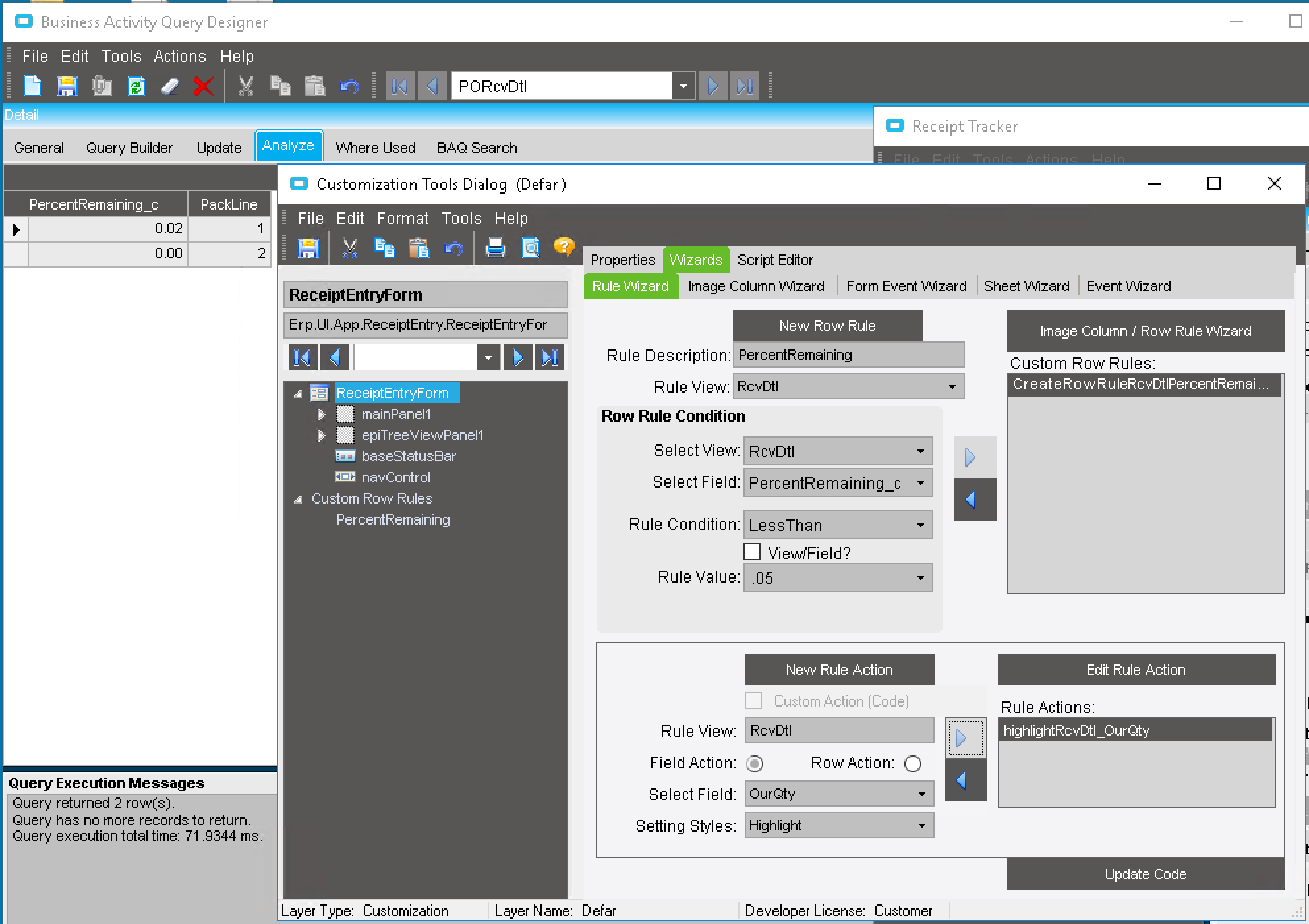

I am trying to use Rule Wizard to create a rule that highlights the Qty Remaining field in Receipt Entry if (Qty Remaining / Qty Ordered) < 0.05. This meant to be a visual cue to the person in receiving that maybe they should mark it as Received and Complete if less than 5% of the quantity is missing.
But when I go into the Rule Wizard I can’t figure out a way to do LessThan a percentage of a field. I can only select LessThan the value of a field. Am I missing something or is there just not a way to do this in Rule Wizard?

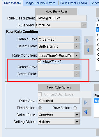

Okay … I can duplicate the issue. An odd thing that happened, was after making the rule (rules condition my UD field < 0.05), it appears to have changed it to a view field, but without a view or field selected.
I deleted that rule and recreated it. Now it shows properly, and works.

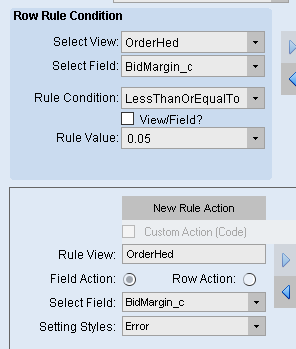

Ex: In the following, the ...Equals_0 Warns the BidMargin_c field (sets to Red), and ...LessThanOrEqualTo_0_05sets it to Highlight (yellow)
		CreateRowRuleOrderHedBidMargin_cEquals_0();;
		CreateRowRuleOrderHedBidMargin_cLessThanOrEqualTo_0_05();;
The When zero it would show as yellow (not red), because the <=0.05 is processed after the zero check. Reorder them to like below to show yellow when <= to 0.05, and red when = 0.
So I had the same odd experience that even though I specified “Rule Value” it reverted to “View/Field” too. Deleting it and recreating it fixed the rule condition for me like it did for you.

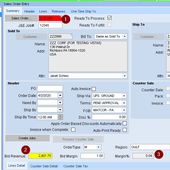

I have two actions for a rule based on a UD field being less than 0.15
  • OrderHed.OrderNum to style Error
  • OrderHed.BidRevenue to style Warn
As you can see below,
  • The Epicor field OrderHed.OrderNum (1) is Red
  • The UD field OrderHed.BidRevenue_c (2) is Yellow
Because the Row rule is fro when OrderHed.BidMarginPct_c is < 0.15
So you can have the row rules affect builtin fields. (or at least I can)

In that picture above, users enter Bid Revenue(2) and Bid Margin. Margin% (3) is calculated as BidMargin / BidRevenue * 100.
I originally had a BPM to calculate the Margin% and store it in the UD field (OrderHed.BidMarginPct_c). But that would only update when the order was saved - which was okay for us as we used those values for later reporting.
To make the contol showing BidMarginPct update when either of Bid Revenue or BidMargin changed, I made form events on their controls. The functions then calculated the value to be displayed in the Margin% control.
