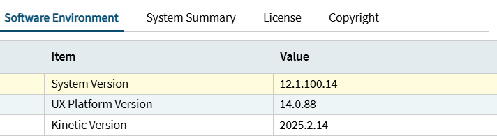

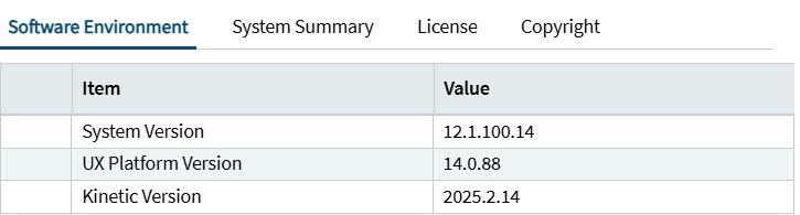

What version are you running? Most known Linux issues are fixed at 2025.2.15. Unless you have upgraded to that version yourself from CMP or support did it for you then you are probably on 2025.2.14.
Yes, we’re on 2025.2.14 in Pilot…that’s what Support put us on, we haven’t tried CMP.

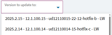

If you can, give .15 a try. If you still have path issues we can investigate.
And this goes for everyone and all Linux issues. Most known issues have been fixed in .15 so if you are experiencing any issues you suspect are Linux related, consider updating to the latest available version on CMP. I think we’re at 2025.2.15-b at the moment.
