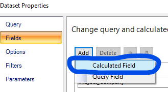

It looks like the CustomerShipTo data source already has a state in field in it. I’m assuming it’s the abbreviation. Can you confirm that you see that and it shows up on your report? If you get that, you should be able to do a calculated field and just base it on the abbreviation to spell it out…
Yes that is the abbreviation. What would a calculated field for this look like to get the whole state spelled out?
Then click the Field Source function button…
I would do a Switch statement and then list out each 2 digit abbreviation along with the spelled out name. I have copied and pasted the finished function to help you out…

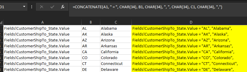

In the future, if you ever need to construct something like this, I am a big fan of Excel. I was able to Google a list of states and their abbreviations and then paste that into Excel. Once it’s in Excel, you can insert the bits of code you need and do a concatenate on a row… then easily paste it to all the rows. Then that copies and pastes neatly back into a text editor.
