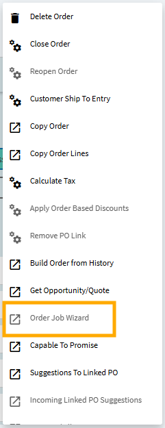

I have few parts for which I’ve entered a Sales Kit part, but when I use it in an order it does not let me create jobs for the Manufactured components of my Kit.
The “Order Job Wizard” is grayed out and unavailable on this order.
Also, the “Make Direct” checkbox is grayed out and unchecked on the order release.
I can ship all of these lines and invoice, but can’t create jobs.
Any ideas???

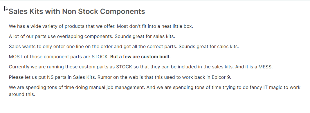

Personally, I have given up voting for Epicor ideas, but, you can always vote for this if you like. You are far from the only one who wants it to work that way.
The link didn’t work for me but I found it, this one should work KIN-I-3389
Alisa, thank you so much for your response. It’s good to know that I’m not the only ONE.
