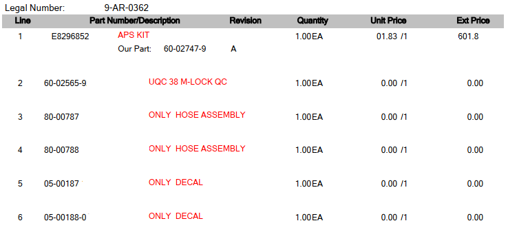

Hope someone can help me out. I’m trying modify the ARForm so that only one line shows up for each sales kit on the Invoice. But at moment its printing all the components in the kit as well, each on there own line. Its confusing our customers. View image below to see whats printing. Line one is the parent kit, line two is the start of the components.

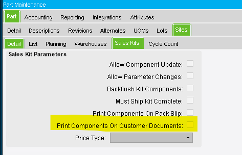

Have you tried unchecking Print on Customer Documents option in the kit parameters?
Hi Bryan,
Yes I played around with that option, but all the lines print on the Invoice regardless if it’s tick or not.
If you’ve already created an Order for the Sales Kit, those parameters won’t affect existing Orders/Shipments/Invoices. The Sales Kit Parameters are copied onto the Order when a Sales Kit is added, so you will need to go into the existing Order and change the parameters that were copied.

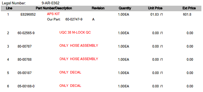

I added the following to the row visibility to the area of the APForm SSRS.
=iif(Fields!OrderLine_KitFlag.Value = “C”, true, false) .
All works as intended now.
