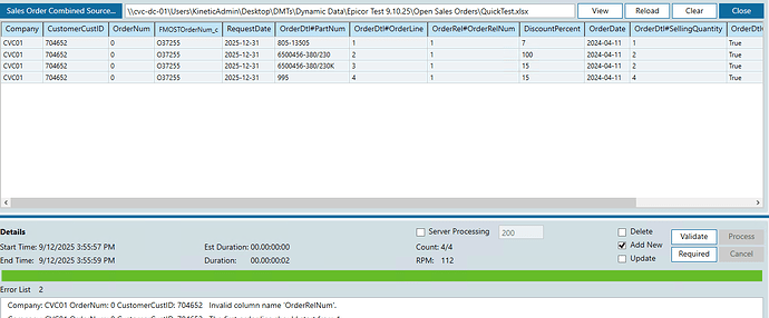

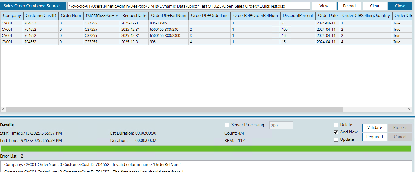

I am prepping for a go live and I am running into an issue with the Sales Order Combined DMT. It seems to work fine for most orders but when I have an order with multiple lines, some of them error saying “Invalid OrderRelNum”. Each of these lines is 1 release and no matter the setup I try this error keeps coming back. This doesn’t apply to all of them either. It seems to be random.
I have tried remove the OrderRel#OrderRelNum field completely, setting it 1 for all records on the order, and setting it 0 to see if would create it.
3 of the 4 lines create the lines correctly and the 1 release with any of these setups but the 4th errors no matter what. I have other orders that have the same exact setup that entered fine via DMT and some of those have lines that aren’t in a sequential order. One of them went from line 1 to 5 to 6 and went in just fine and created the lines as 1,2, and 3 on the order.
Has anyone ever seen this before? I can’t find anything so far in the data that explains this.

Thanks for the suggestion. I moved the OrderRel fields. It looks like anything that errors with the “Invalid Column name ‘OrderRelNum’” actually DMTs just fine.
