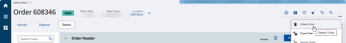

I’m in 12.0.100.5 and I can’t delete a Sales Order. Looking for someone to confirm it is missing or that I’m an idiot (in regard to this problem only).
I even opened the layer and the delete tool was not listed.
We still have Delete in both Classic and Kinetic

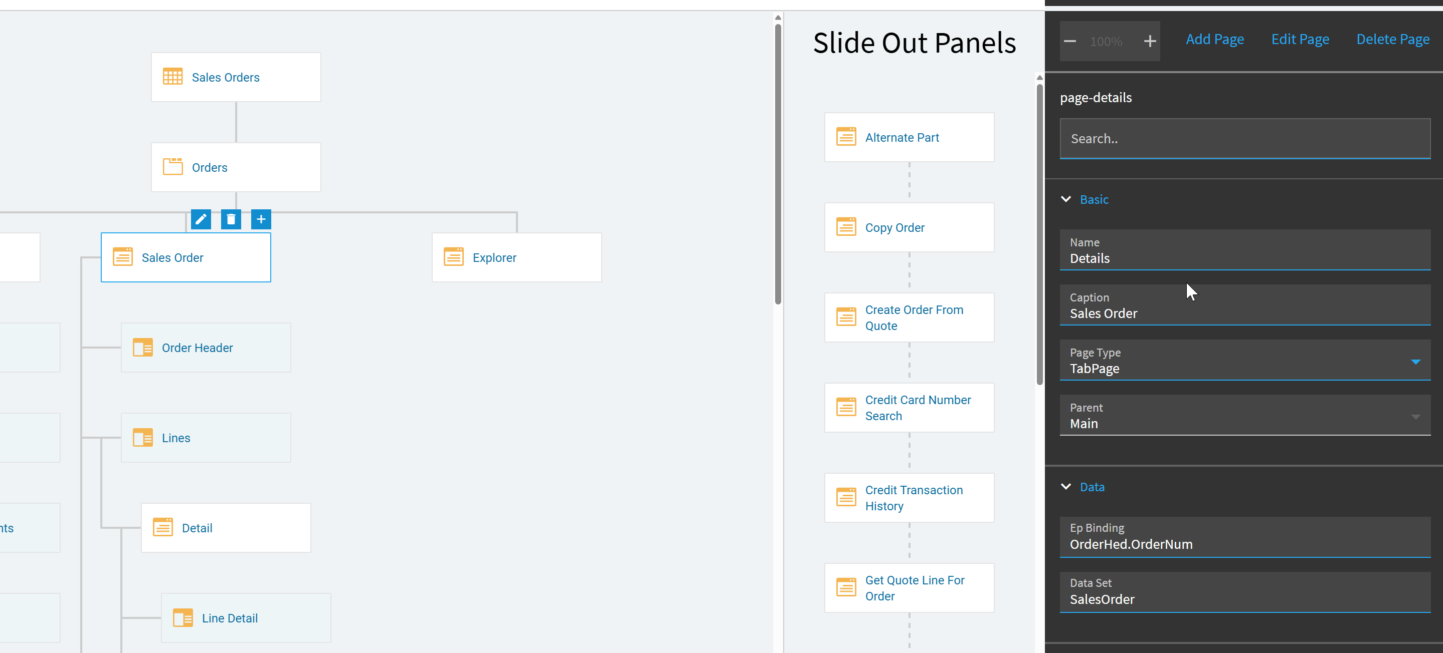

Please verify that the epibinding is missing, as indicated below.
Thanks @surendrapal . Appreciate the help. The epbinding was in fact empty.

Upon observing the upgrade or modification process of layers, I observed the deletion of epibinding. I suspect this is the underlying issue.
