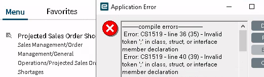

If you run (or can run) multi-level pegging you should consider using Projected Sales Order Shortages
it just shows all open Sales Orders with the values of them

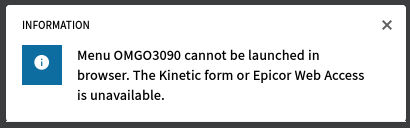

I’ve never been able to get that to return anything on the desktop, and there’s no browser support. Does this dashboard actually function for other users?
We use it here. You need to run the multi-level pegging process in order for it to populate with data, maybe that is your issue? :man_shrugging:

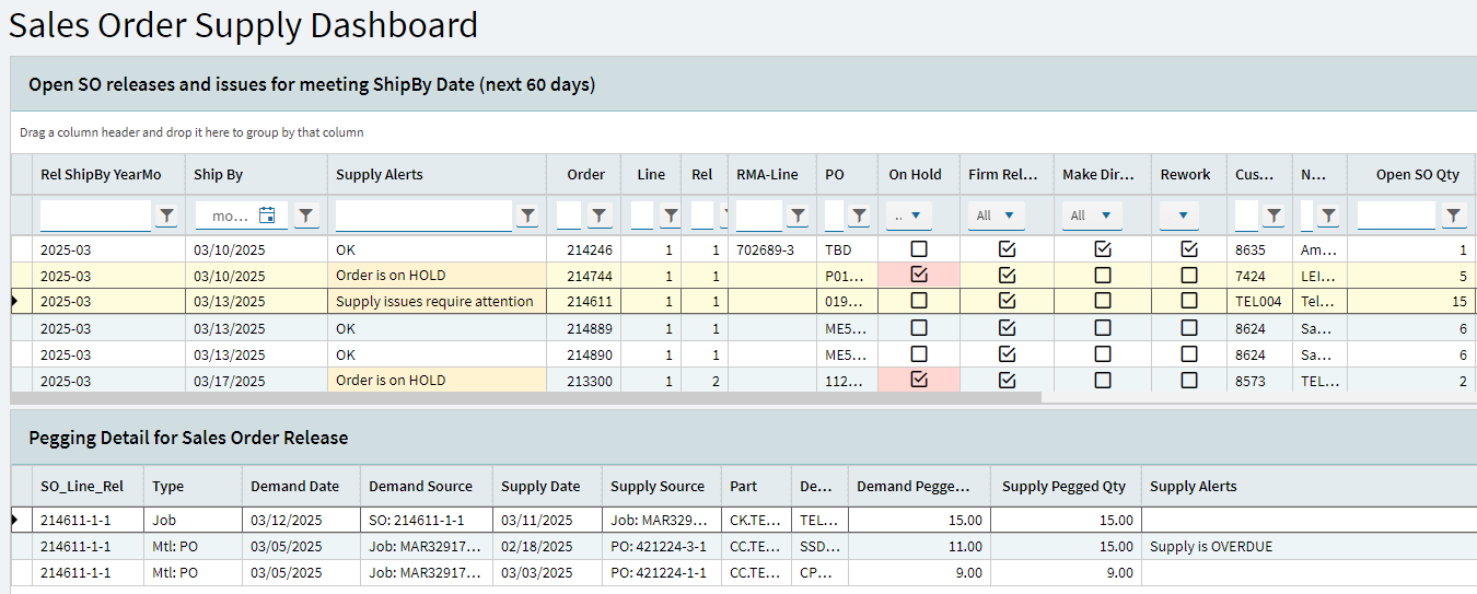

Attached is the solution CAB file.
This is designed to display data for the currently selected site.
It also isn’t optimized and if the site has a lot of SOs it may timeout. I plan to fix that but haven’t had time yet.
SOSupplyDash_Customer Solution_4.3.200.0.cab (235.1 KB)
