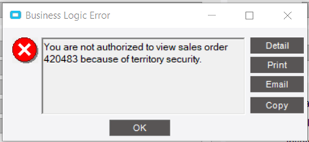

Following up on this, now that we are on 10.2.700.6. Nothing has changed. When I try to access an order through Order Tracker, I get this message:

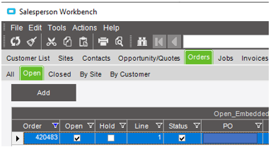

However I can immediately log into the Salesperson Workbench and access the order and get all the information I want out of the SPWB.

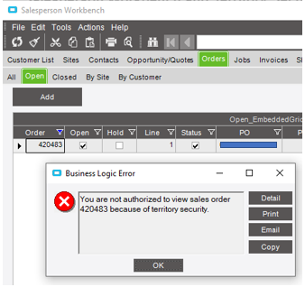

And to continue the folly… it does still say that I am not authorized to view the order (when I try to Open with…), even though the SPWB is presenting me with all the information.
