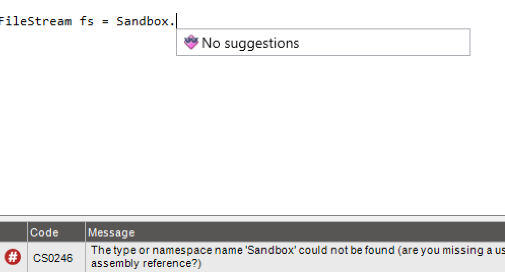

I am not finding the assembly reference to Sandbox.IO so not sure what Assembly reference I need to add and what using statement. I am reaching out to contacts I have at Epicor to see if there is more information available.

Still not out of the woods. Even after adding the assembly reference and the using, it is still missing something.
I tried Marks code but get the same missing reference error.

In a function, use this.Sandbox.IO, see this post for some info, you don’t need a reference for it.

This gets me closer. What is throwing me is that there is no code completion (Ctrl+Space) after this.Sandbox, you just have to have to have the correct syntax for it to work.
I mean, yeah. You might be asking a bit much of Epicor now :wink:
