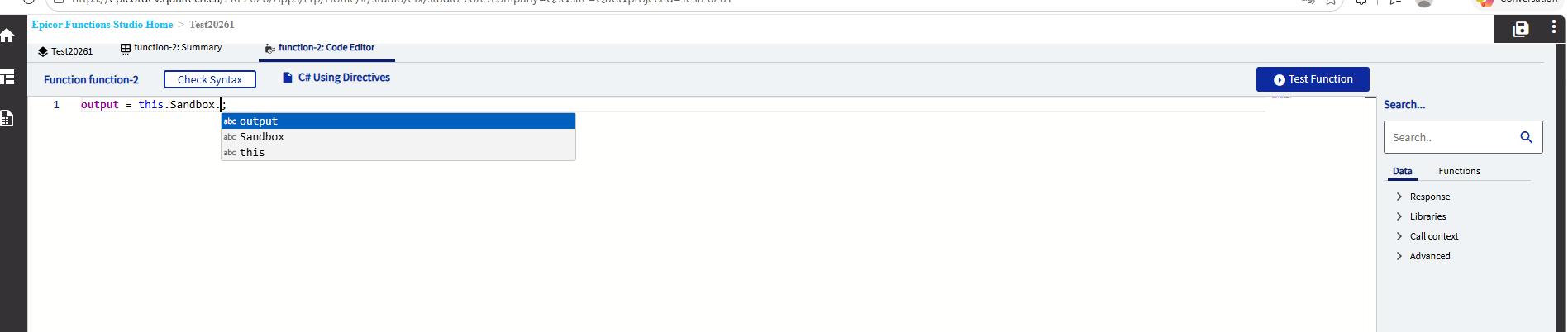

We installed an on-premises version of Epicor 2026.1, and we are trying to use the sandbox environment variables mentioned in:
Whats New_Kinetic_2026.100 (2).pdf (539.0 KB)
But all we get is :
Has anyone encountered the same issue, or has anyone been able to get this working like in the pdf?
cast it to ISandbox and the auto complete will behave.
Wasn’t some code updated to sandbox on an upgrade. I’ll have to check my notes but think we had a few functions were touched by this.
