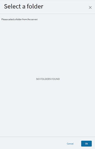

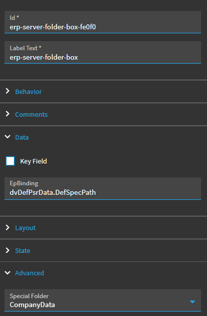

When using the erp-server-folder-box set up like this:

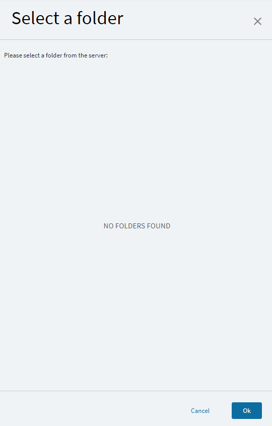

The result is:
There are 8 folders in the under DTSF.
What are we doing wrong?
